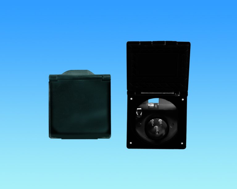

The socket is easy to replace. It is held in place with 4 Torx screws.
Undoing the power cables and refitting them in the new socket is just like a 13amp plug and then it goes back into the plastic surround. All accessible from the outside.
The only slight complication is that the cables are covered in a foam sleeve but this pushes back easily. This is used to prevent the cable from rattling against the body.

Had a look at mine to check and this EBAY one is identical
MAINS 230V 16A FLUSH INLET SOCKET BLACK CARAVAN CAMPER EHU MALE IP44 HOOK UP M

I've patched the flappy bit for years with superglue - but it irreparably disintegrated recently. I bought the replacement suggested higher up on this thread and swapped broken for new in about a half hour. Taking a photo of the connections before de-rigging is handy because the wires do twist and turn a bit ;-)

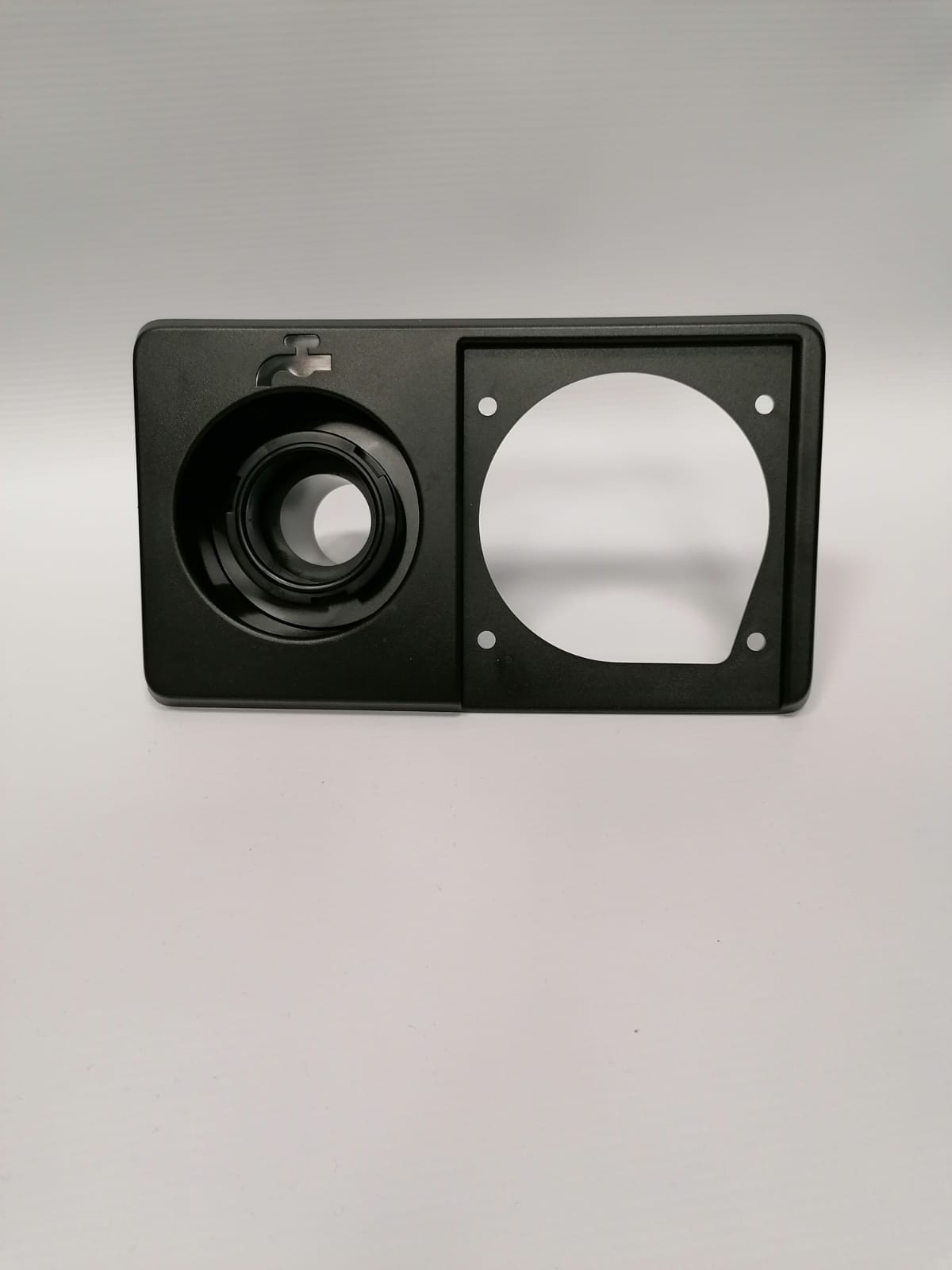

Can you point out we’re the replacement flap is please, I’m needing one.
Clicking on the link shows me just the base plate
Got mine from an Ebay supplier.
