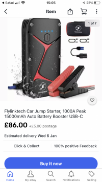

Carry a small battery pack / jump starter similar to the below:
