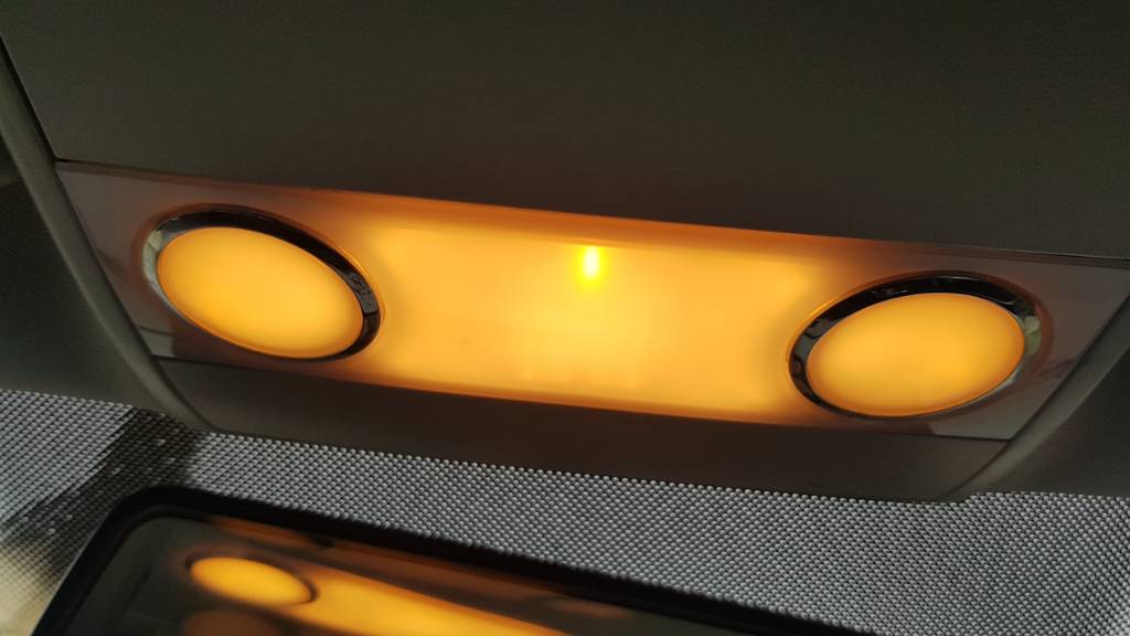

Does anybody know how to get this open before I attack it with a screwdriver?
I've changed the bulbs in the kitchen area (apart from the strip light) and want to do the rest if I can.
Also is there now a bulb that fits straight into the strip light? In the past I've seen members on here who had to resort to wiring in bulbs, it's not something I'd be comfortable doing.
Also while we're at it how do i get to the bulbs in the footwells?

Maybe this helps (sorry only in German)
Translation for you
Bulbs and tools are in the description.
Turn the socket to the left
If the LED lamp does not light up
Turn the polarity through 180 degrees
Change this lamp as well
Use this wedge for the passenger compartment
So you could change the middle lamp
Without dismantling the glasses, the socket is turned to the left
Shatters the correct polarity of the lamp
Do the same on the other lamp

The fitment for my 2018 Cali is nothing like those in the video. The bulbs are therefore redundant for me
I have started LED’ing interior lamps (centre console) but as ever want to carry on to change others such as sunshade lamps etc. Has anyone listed whats needed and a quality source?
I replaced the doorstep bulbs to Aliexpress leds, but I have not found decent ones. The LED's are dieing one after the other, but it looks wonderful.IMG_20180405_175032.jpg
You need a T5 fitting (really!)
