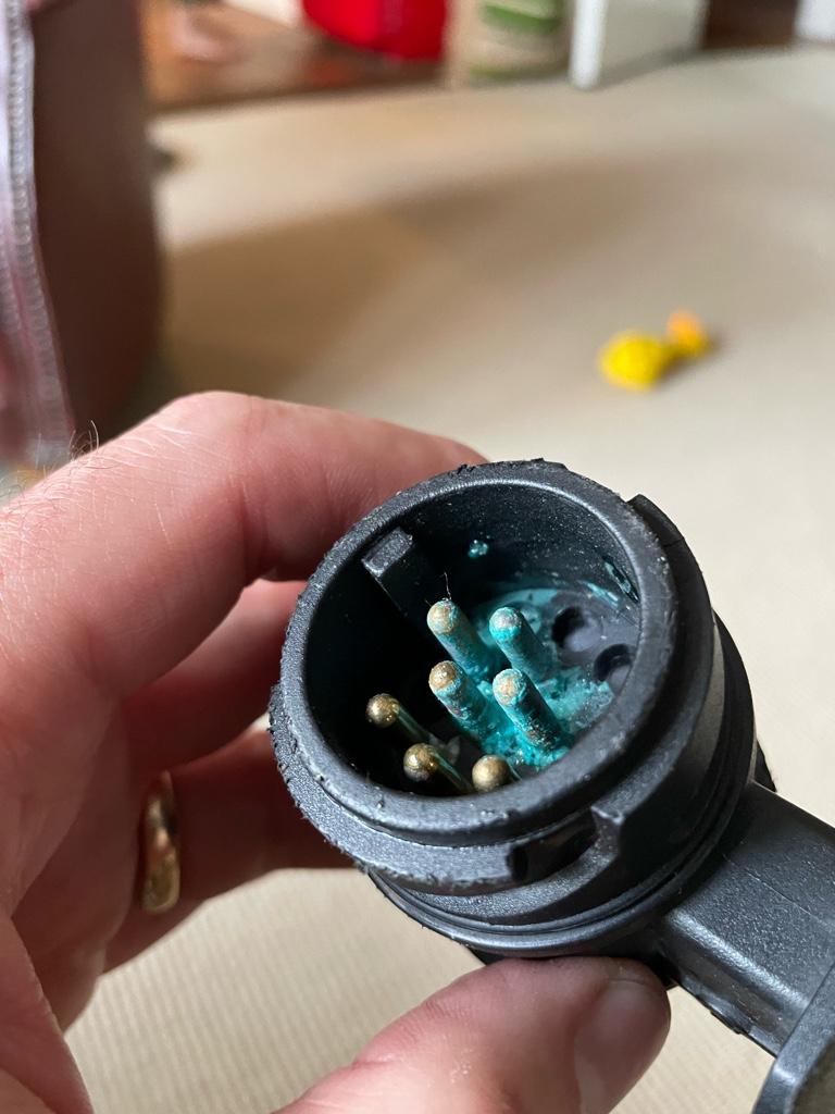

Turns out a trailer light warning message was due to a corroded adapter. Easily replaced but any tips for cleaning the van side sockets? Separately looks like the adapters come in different materials - any recommendation for one where future electrolysis/corrosion will be less?
To answer my own question after a bit of browsing it looks like an adapter with nickle plated copper connectors would have been less prone to corrosion than the adapter with copper connectors that I’ve been using……

You have made met think I had better start spraying my van and bike carrier electrical connectors with contact spray more frequently. Thanks for flagging this. I bought Halfords own brand contact spray as it was cheaper than WD at the time.
A combination of contact spray and sand paper on the contacts and a new adapter has resolved the bike rack ‘bulb’ issue without actually changing the bulb. This was just as well as for some reason the bayonet on the replacement 380R bulbs I got hold of doesn’t quite fit………. Thanks again for contact spray tip.
