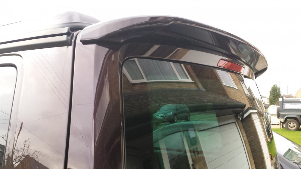

I've had a dealer fitted (not available as a Factory option) rear spoiler.
On a more detailed check today I've found that the rear washer nozzle is now buried inside the spoiler and water slowly drips out of it.
Anybody else had one fitted and should there be a cut out or more sensibly the washer repositioned onto the spoiler?

That's interesting. On the T5 the washer jet is intergral with the Wiper Spindle which is at the bottom of the Tailgate Window.

ditto to WG on my T6 --- where did they put your spoiler!

Spoiler is on the door metal top.
I thought the washer would be on the spindle when I couldn't see one.
When tested no water at first then foam started to come down from top above brake light.
Trying to find out what would be normally be there before contacting dealer on Monday.
Ah Ha. got it sussed. Head in shame.
Got a bit of help this time to check and watched what was going on from outside the back
The spindle does supply the wash jet but it goes up past the window & hits the spoiler then dribbles back down.
obviously a bit of jet alignment needed only.
Thanks for pointing me in the right direction.
