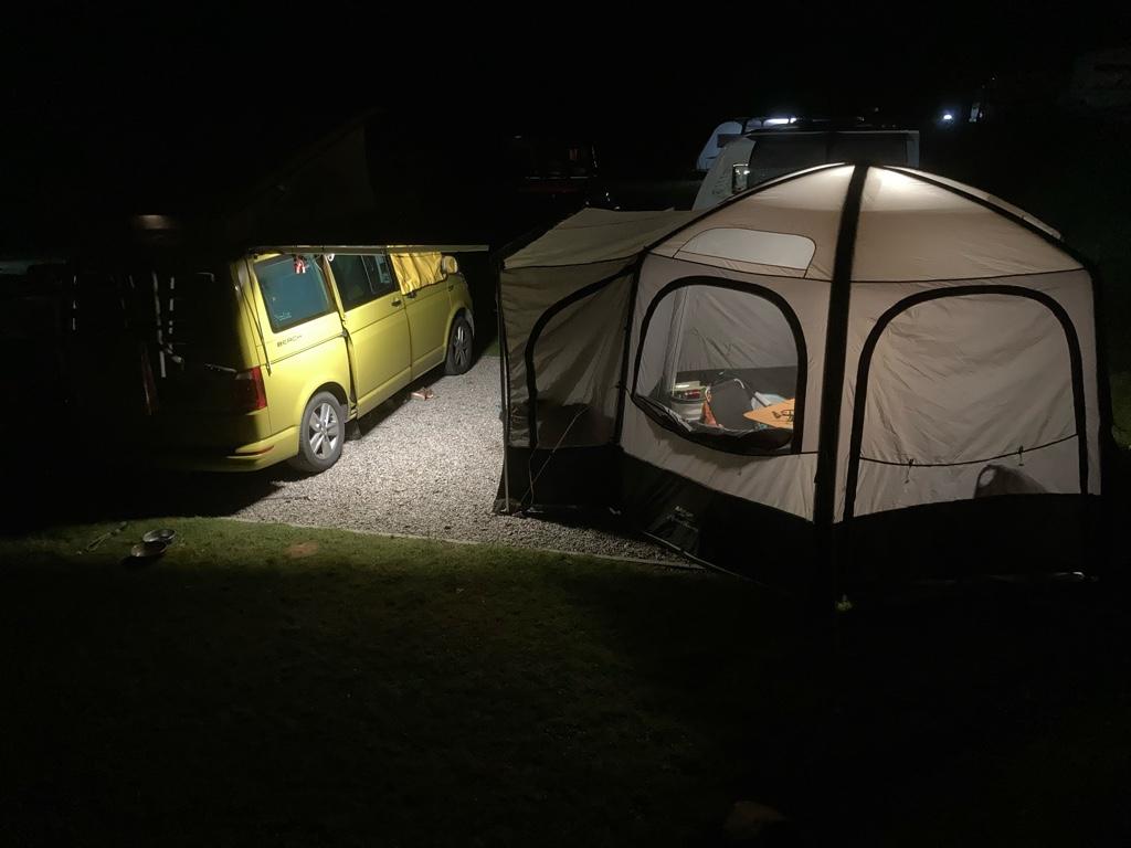

Our setup is this:
1. Battery to Anderson with 50a fuse.
2. Anderson to 2x Anderson, one with 20a fuse.
1 & 2 within the battery cavity, the 50a fuse is to protect the battery, the 20a fuse to protect the fridge.
3. Long Anderson to Anderson concealed under trim to boot jack cavity.
4. Anderson to 2x Anderson, one with 20a fuse.
5. Long Anderson to Anderson under the trim to the tailgate loom, out of the loom through a small induction and across the tailgate to the awning, through a small hole drilled in the awning casing where the Anderson connector sits in a cavity.
6. Anderson to 20a fused Anderson and 5a fused Vango lighting connector.
7. Various lighting and Anderson extension leads.
We can place the fridge behind the front passenger seat, under the multiflex, below the awning or several metres away in the driveaway awning. We can also fix Vango’s external lighting under the awning canopy or in the driveaway awning or both.
During our recent camping trip to the West Country we had the fridge behind the passenger seat for travel, then in the driveaway awning when camped. We had a switched light under the canopy and separately switched lights in the driveaway awning.
When we drove away for the day we moved the fridge from the kitchen area of the driveaway awning into the boot.
