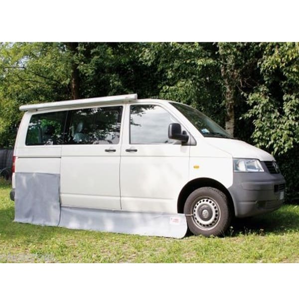

Thanks for the responses so far. One additional thing I forgot to ask... might be another stupid question. The awning will of course be attached on the driver's side, which is also the side I believe that the diesel heater vents from. Does this mean the heater can't be used when the awning is up.... would we get all the diesel smell in there coming through the tunnel into the main part of the awning? Just thinking of a scenario where I am chilling in the awning but the kids are in the roof of the van and need some warmth.
Yes you are right. If the wind blows in the right direction you can smell diesel fumes.
We bought a plastic baffle that clips between the front and rear wheels, pegs to the ground and effectively seals off the area under the van. Was around £20.
On one occasion, before we bought the baffle, we had ducks wondering beneath the van and in to the awning.
You will have the potential of diesel smells no matter which side the awning is attached to, if the wind is wrong, it’s pot luck. Last autumn we used the diesel heater a couple of times and then I slept in the awning with no noticeable smell.
If you’re concerned though, and you’re on an electric hookup, you could invest in a little electric heater (“free” power - might as well use it)
Might be good for inquisitive foxes snooping around, which we’ve also had. Where did you find the baffle if I can ask?

We have a footprint, lay it out first, helps protect DA when you're pulling it around on the ground or folding away.
We don't have a skirt just yet, but do keep looking at this one:
It was bought via ebay. The seller is just-kampers. The price has risen but still available. It works for us.
