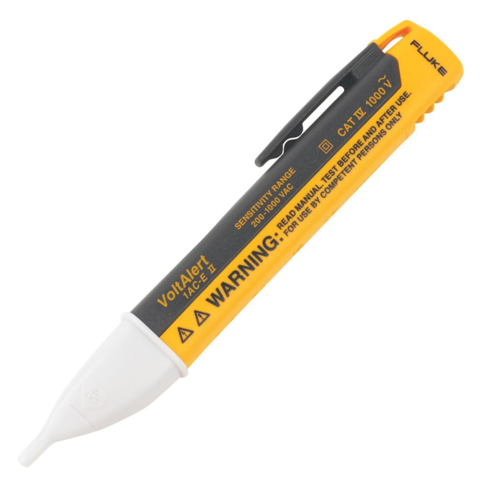

Invest in one of these and keep it in the glove box. Invaluable.

Ok firstly the Voltstick is only for 240v not 12v.
It’s just useful to confirm a cable is live. Hold the tip near the cable and press the button. If it squeaks then you have power.
