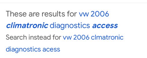

Type this in and it seems to produce credible Intel.
Did the search, most of it is about a different (later) model. Thankfully i did find some new info to try later.
