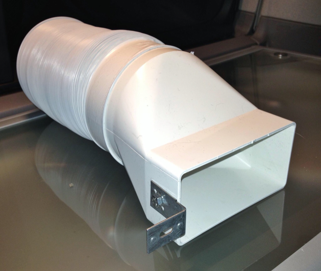

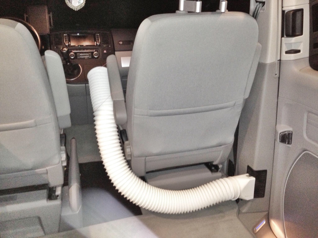

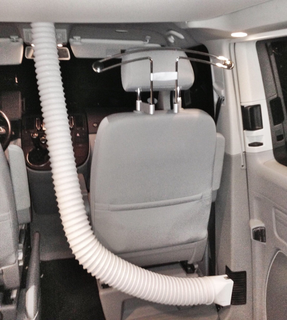

I have a solution with a tube now which is working pretty good. It is a foldable contraption that guides a warm air directly from the vent to the top, leaving bottom cool and tent comfortable. (Need to make a photo of that)
Yes, a photo would be great please. :thumb

Because my vent is in the seat base I may add a Y piece to my heater to have a second pipe pointing out of the front of the seat and slightly up, should help the heat get up there.
Just found this in the German caliboard.de from „Salzman“. He‘s great in doing cool stuff!
