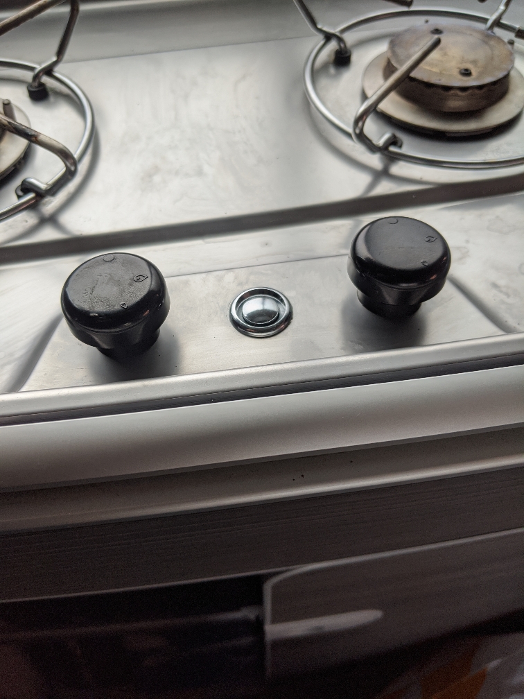

Forgot to update but got van serviced end of Feb at Camper centrum in Amersfoort. They did a great job all round and for 150 Euro fitted a smart new ignition switch (see pic) which is much quieter than the 'plunger' button. I thought they had also sorted burners as worked fine on the day. Later in week however they failed to stay on. After googling some more I sorted myself by spray silicone round the control knobs and pushing down rapidly a few times. This seemed to free the mechanical part of the thermocouples and let me slowly release the knobs to their up position and hey presto no issues.
