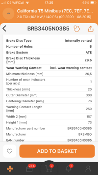

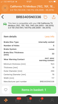

I got quoted €1700 to change discs and pads here in Sweden on my California T5.1 2012 so I thought I'll give it a try myself. Read some very helpful threads here but feeling very unsure if I'm ordering the right size. Judging from the PR code below (1AK) I should use 314mm for the front? From what I read it should be 308 or 340 if I wanted to upgrade (I don't). And for the rear it seems clear that it should be 294 and 22 mm thick. I wanted to go for Brembo.
X11 B4A CK4 G0K HOE J1D D91
1AK 1G2 2PW 1NL 5RQ 5SL TM0
3S4 3U1 0Q1 8AE 8GV
2S4 1BA 7MG
0E1 4UF 4X3 4R1 4K3 N2M SMD
8RM 2JG E0A 2V5 0JE 0YD
1D2 ABR BEL U5A 1N1 3L0 4A3 9N1
Any advice from you pros in the forum? Thanks heaps
