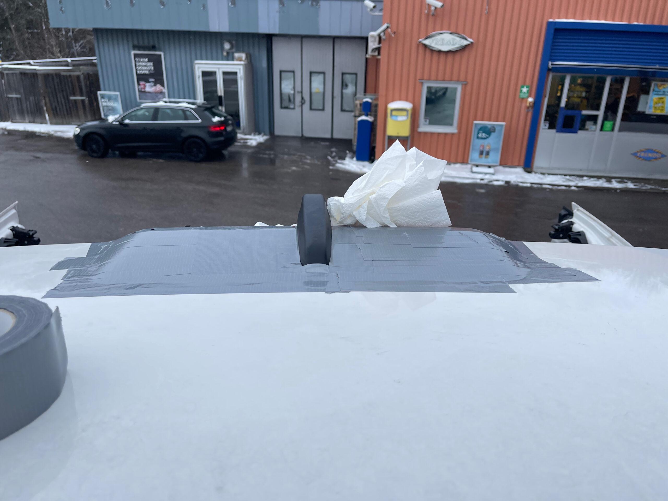

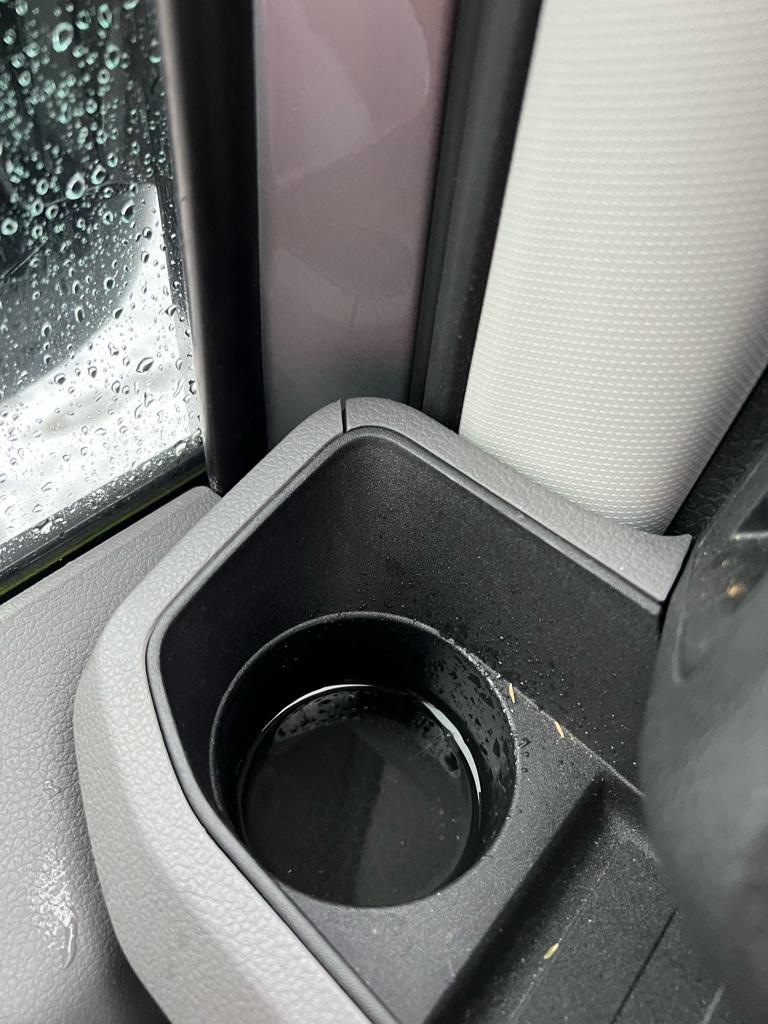

I had that problem with the leaking water down the A pillar to the cupholders some months ago. I sealed the rear brake light( the one in the roof) with butil and never happened again....We live at a very rainy area.
Maybe it hepls It's a very common problem and there is a lot of info about it
If your GC is still under warranty it is a warranty fix. There is a VW TPI describing the issue & fix.

To check if your issue is the 3rd brake light lead look between the headlining and roof over the middle rear cabinet. If around the light fitting and/or top of rear cabinet are wet then the brake light seal has failed and needs the repair. Note that the official repair involves an additional butyl seal that is not part of the original factory build.

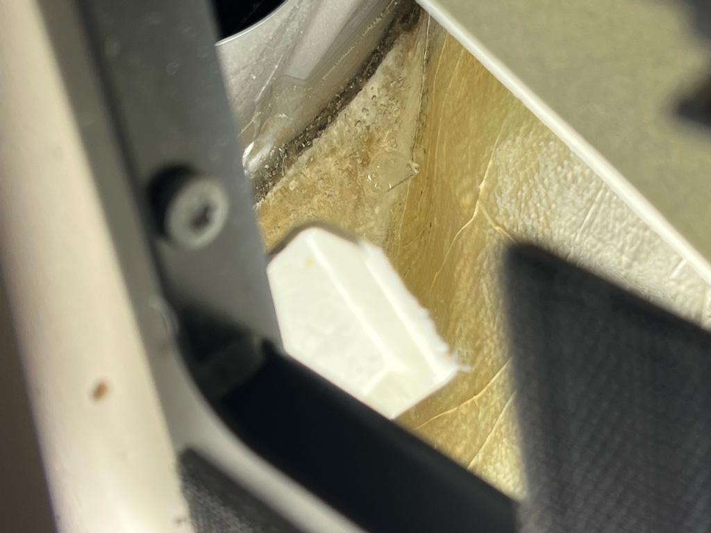

Has any person found where water is getting in other than 3 brake light that are appears dry I checked with camera and can see water lodged in same area in bulkhead above piller can't see where it's getting in
If the rear brake light area is dry then the other place that’s been reported on the various groups is a failed seal between the GFRP roof and the body.

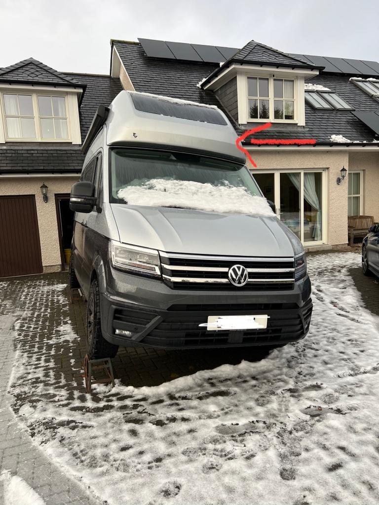

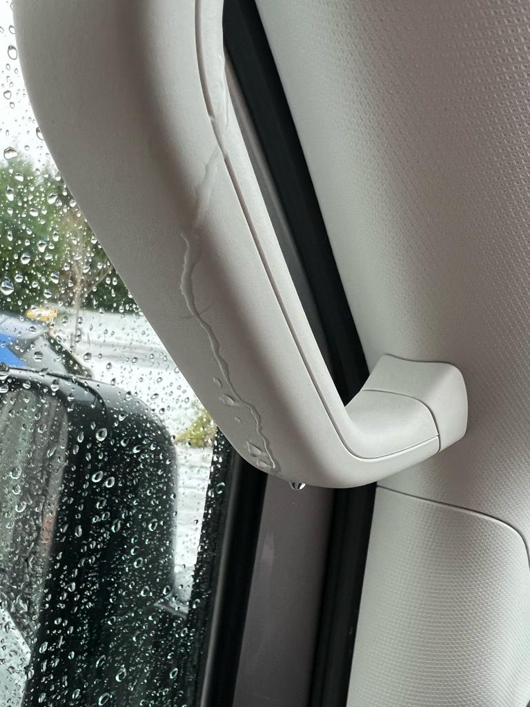

We have traced back the water which is flowing down the handle to the GFPR roof. It appears the water is pooling above the windscreen (at the red line shown in the second photo). We removed the sliding bed and trim around the sides. We inserted a camera at the corner of the bed (Arrow 3). The pictures taken show a pool of water. We inserted a telescoping camera about 2-3 ft further in and this point appears to show water coming through the fiberglass where the label is.
We are at a loss to know where this water is originating from. Is the GFPR roof a doubled layered roof?
We did a test on the rear brake light spraying with water for 30 minutes but this didn't show the issue. We have had it back to the garage twice . They have redone the roof windows but it didn't stop the leaking when it rains.
Any suggestions appreciated.

Thats interesting because I have water leaking into the dashboard and filling the cupholders. I think it might be coming in from the doors and dripping from the front grab handles.

First I had the recall for roof ee windows done by my local vw garage then when I had the water leaking problem I took it back to dealer I purchased it from and they had windows redone but leaking did not stop so it's booked in again for 23 of April in the meantime I decided to see if I could locate the leak but to no avail so far it's 600 miles round trip to dealer
I suspect it could be the seal between the plastic roof and the metal body. I had mine fixed under warranty. The dealer did an excellent job it has not leaked since.
