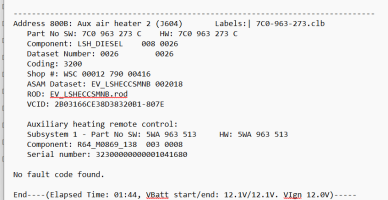

It does seem odd. The only way to really tell is via VCDS and read the software version of the heater. Do you have access to?
As you describe above is exactly what I’m expecting to see once the heater is flashed.

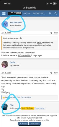

had to just go out in the snow to see what options I have and given it is well into the minus temps and still snowing, disappointed to confirm that I only have the air heater option. Will reach out to the German chap and see if I can get this done remotely as they discribe. Would think Poland gets cold enough to qualify for this but apparently not as standard.
Ok so to close this off, the dongle arrived from Germany. Software downloaded onto the lappy and a very nice gent from Germany remotely connected to my van and flashed the water heater (parking heater).
Now I have a Nordic spec which allows selection and operation of the water heater without running the engine.

9M4 is the auxiliary air heater I believe. Best way to check is the stickers inside front door, two stickers, two heaters one air and one water.

To successfully perform the software update that Sidepod performed on a Coast or Beach T6.1 model, it must already have option 7VF. This is programmable air heating with remote control and water heating (not programmable and without remote control). Option 7VF was listed for €2,100 in the 2021 price list, only for Coast/Beach.
Option 9M4 was listed for €2,600 for Coast/Beach.
Option 9M4 was listed for €500 for Ocean.
With the software upgrade (and larger starter battery) you transform 7VF in 9M4 on coast/beach.
I understand you have already air and water heater, but do you also have remote for air heater ?
If 2 heaters but no remote you have option 7VG not 7VF.
