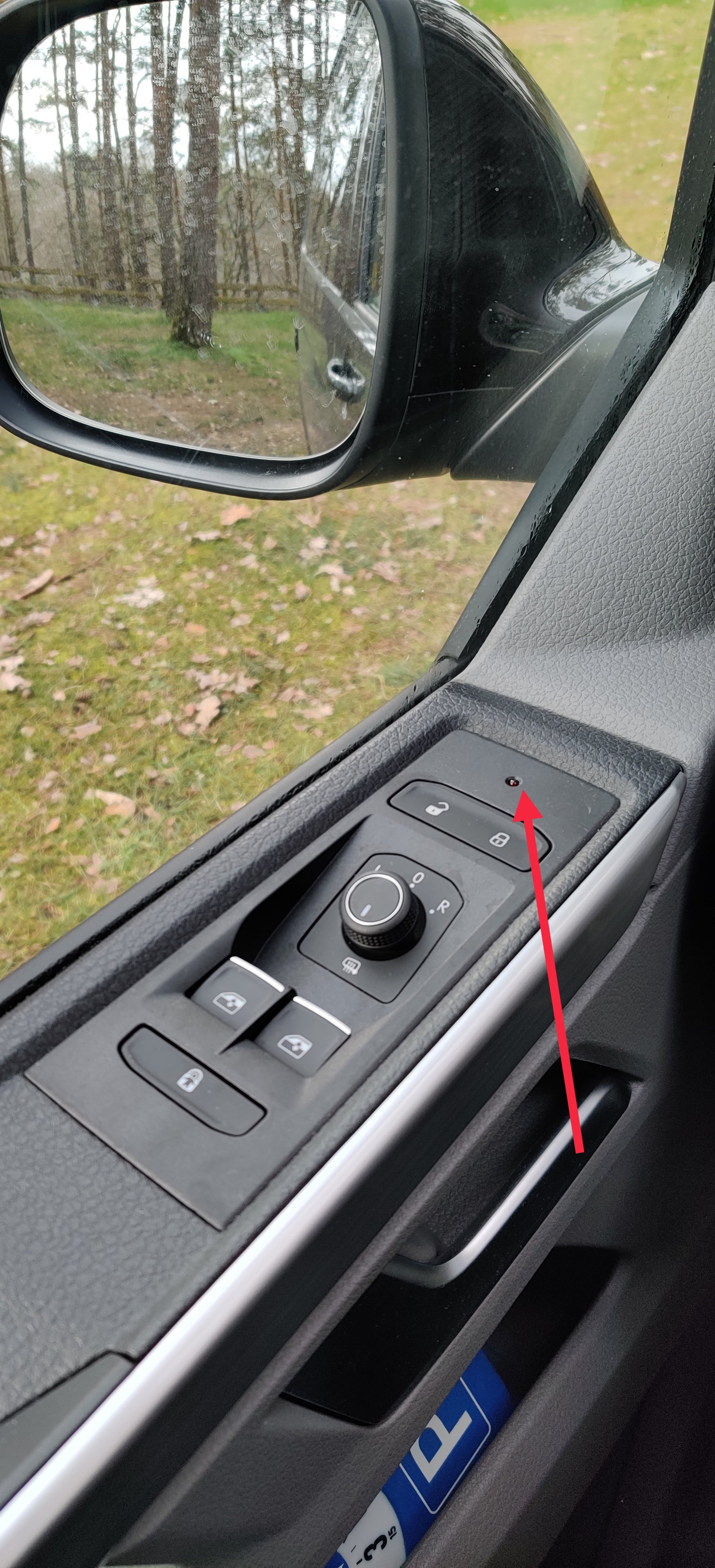

Did you try to press the button to unlock all doors?
Not my van. Found this pic at Caliboard.de. All credits to Hans_87

there is a setting that can be enabled that locks doors when the vehicle is driven and gets above a certain speed ( I think it’s 15kmh) when the doors lock automatically.
To open the doors, after this feature has initiate, you either pull the relevant handle twice or turn off the ignition and remove the key Or use the unlock button near the window controls (similar to picture above) which shows the padlock lock / unlock function on the door card
if the auto lock feature is switch on, you will hear an audible click when you start driving, the doors lock after reaching the required speed.
