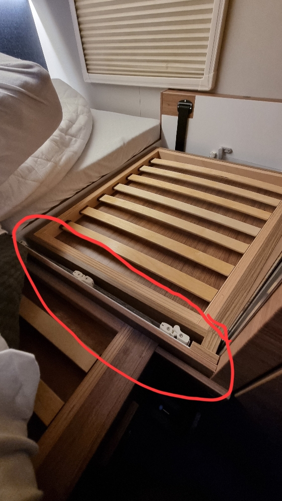

First thing to get out of the way, rear bed comfort is only good on half of the bed without the stupid shower arrangement. Reason is that there is a raised portion that "holds" the pad on place on top of the shower cubicle (will try to attach a photo from my "review") . This raised portion kept digging into my wife's legs while sleeping. If you swapped your head to the shower side, it was even worse. The mattress is quite soft and comfortable. The step into the bed seems like a compete afterthought. It jiggles around feels like it will break with more use.. Supposedly they updated this part.

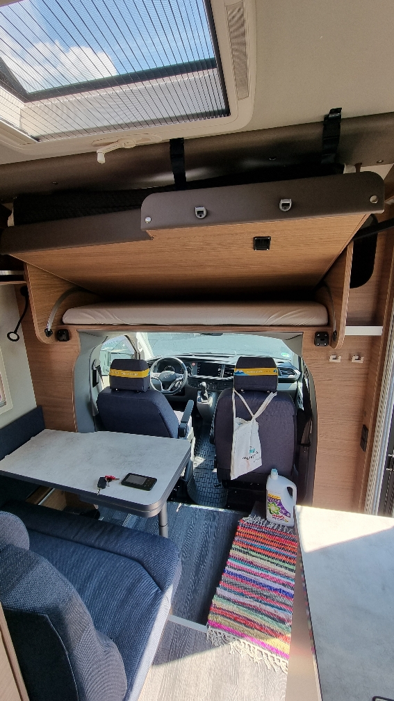

The upstairs bed with the ladder in place - you can't open the bathroom door. You must remove the ladder, get under the bed and then you can open the bathroom door to get inside - if someone puts the ladder back in you will not be able to escape the bathroom. If you are sleeping in the rear bed - to get out, ladder needs to be removed as well. There is almost no room between the two beds to move around. We never used this bed and just chucked all our laundry and other stuff up there.

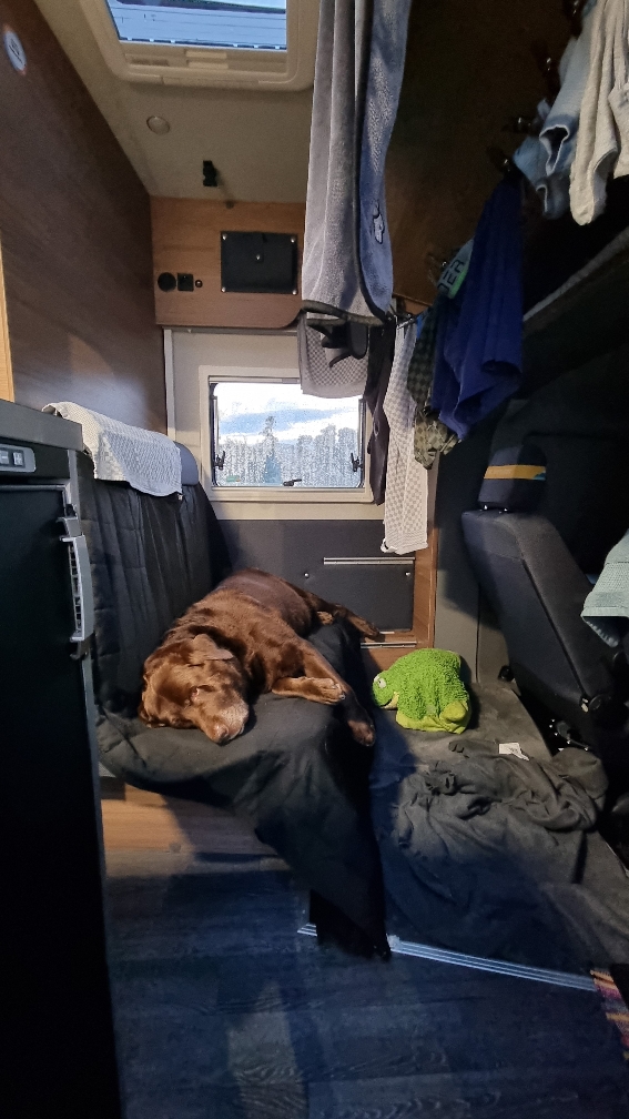

The oddly shaped floor behind the drivers cab is quite stupid. Our Labrador kept falling onto the different floor cavities and we grabbed his bed with us so he could easily lay there. The floor should be flat, we tripped on it many times just getting around the van. See the image with a floor mat covering one of the odd raised parts of the floor.

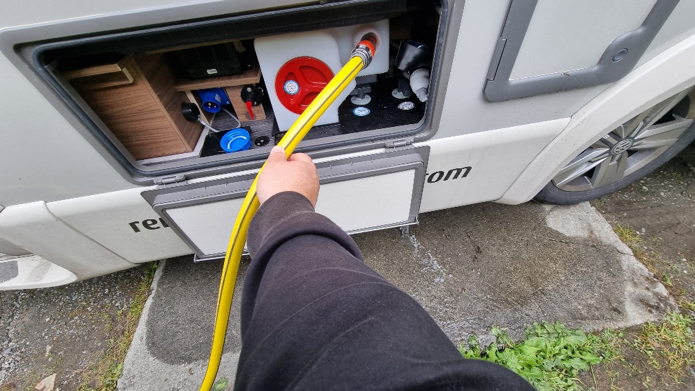

Trunk/garage space is fantastic. Diesel heater was also very good. Very good water filling and draining option. I like the hidden cable hook up behind the access door - has the water fill there as well. Windshield blind for nite time needs to be rethought.. I would just use an external blind.
