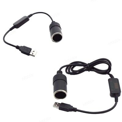

Yeah I’ve seen them. I want to do the reverse on a T6.1 Cali Ocean. I never use the USB’s and a 12v would mean my telly can be plugged in easily.
Thanks for the response. I did look at that. Unfortunately the wattage won’t be enough to power my 12v. Ideally I need to take the USB sockets out and do a straight swap with a 12v socket. Surely if people have done it the other way around, it’s possible?
Remove the USB socket and check the voltage it is supplied with.
If it is supplied at 12 volts you could change it. If it is supplied at 5 volts it would require running a new supply from a 12 volt fuse. I don't know how these usb outlets work but it is likely that the voltage is reduced to 5 volts at the socket.
Probably easier to fit a 12v socket directly to the leisure battery with a suitably fused connection wire.

It’s saves costs for the manufacturer, as they will most likely use a thinner gauge wiring inside the van for USB, so be careful what you plug into it if you use a usb to 12v cigarette adaptor.
Better to run a direct fused feed off the battery, with a nice thick wire as per WG’s post. Especially for something like a fridge, cooler, 12v kettle etc.
I'll admit, I too would prefer a standard 12V socket in that location too. It would keep your options open. Pop in a USB adapter if required, remove it for larger appliances with the old 12v cigarette lighter plug.
