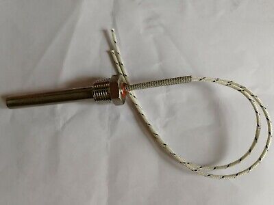

    1. The heating element that I shared in the earlier post with you is a 240 V one. These ones are most efficient when it comes to keeping the water above freezing. You are not looking to heat water, just don't allow it to freeze. This is only when on Hookup.
  6. When parked and NOT on hookup and only on battery power, there are 12v heating elements that can be plugged into the 12v leisure battery. but it will put additional strain on your battery. The steps mentioned in 1,2 and 3, should help you with the low temperatures.
  7. If you want to use the 12v heating elements, also consider putting a relay that will switch off the heating element if the leisure battery falls below a set voltage.
Below is an example of a 12v heating rod that you can plug into the side of the water tank. Plug in at the lowest point possible so that it warms the water above.
The last thing that you could do - all the pipes that you can see, wrap with some kind of thermal insulation such as - https://www.airconspares.com/armafl...0DCi_HpgXV5whsLzBeKoe52Q1jiIujLgaAnrXEALw_wcB
I would start with the first three and also the pipe wrap with thermal insulation. Then, depending on your needs, do the other items such as the heating element as that will have a big drag on your battery.
