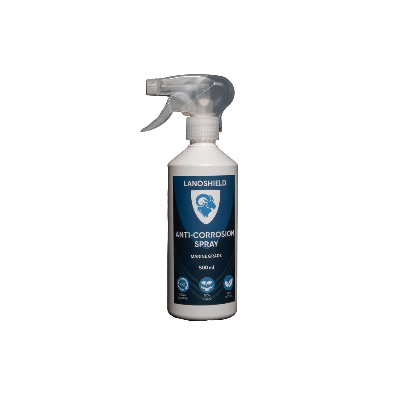

Has anyone used this product? The main reason I ask is I am assured by Lanoguard that applying it between a California roof and body will stop any galvanic corrosion dead and thus eliminate the roof corrosion issue. I didn't fancy greasing my roof up but videos on their website show it wipes off to leave a clean, transparent film.
Sounds good but is it too good to be true ?

As far as they’re claims regarding the California Roof - Snake Oil.
The galvanic roof corrosion is between aluminium roof and steel insert in the rubber seal around the edge of the roof. Nothing to do with the body.

Thanks @WelshGas, it does seem rather too good to be true. I was thinking of the chassis rather than the roof and had my previous camper waxoyled which kept her solid despite her age and many wet camping trips and being kept on the drive year round. Was wondering is anyone does anything with their calis or T6s that’s different.
T4s can be prone to rust but the T5/5.1/6 , apart from the Galvanic roof corrosion seem to be well protected.
Waxoyl and Dinitrol products do have a good track record .
Good to know thanks
Did mine with ACF 50 before winter and when the wind and rain permits I'm going to check it and redo if required.
Looks a similar product in theory.

Took the plunge and applied Lanoguard to the underside of my Cali. So pleased with the results, easy and quick to apply D14E9F93-F14E-4AD2-9630-5210EF525B56.jpeg3B22DFB7-01F8-47DD-9FB9-274F5B374CD4.jpeg
Took the plunge and applied Lanoguard to the underside of my Cali. So pleased with the results, easy and quick to apply View attachment 86668View attachment 86669
Looks good. I got a some a month ago and am waiting to take it round to a mates garage to get it on the ramp or over a pit. Too old to be lying on my back under vehicles any more.
David. Did you remove the plastic undertrays and treat the body there as well?

I haven’t removed the under trays as yet although I do intend to do so. I still have two wheels to remove to do the suspension properly so I’m slowly working around the whole vehicle.
Have to say, it’s marvellous stuff !
Hi I am going buy some lanoguard for my defender and really tempted to give my Cali a good covering it gets amazing reviews on the Land Rover forums,the best bit is it can be applied to plastic so no need to mask off.How’s yours holding up?
It’s excellent stuff. It still looks like it did in the photos I posted last year. This stuff does what it says on the tin and doesn’t come off.
I bought a kit which included Lanoguard, grease and spray attachment. I still have half a container of the Lanoguard and almost all of the grease.
I would definitely recommend it.
It gets good reviews including from the 4x4 community and others whose vehicles get regularly blasted by stones etc underneath. I have a couple of vehicles that could so with it but all have some surface rust on chassis/underbody/suspension components. By using Lanoguard direct onto that it will just lock in the rust so I know the proper procedure will be to Jenolite (or similar rust converter) first, but not sure if I can be @rsed, may just try the Lanoguard.
