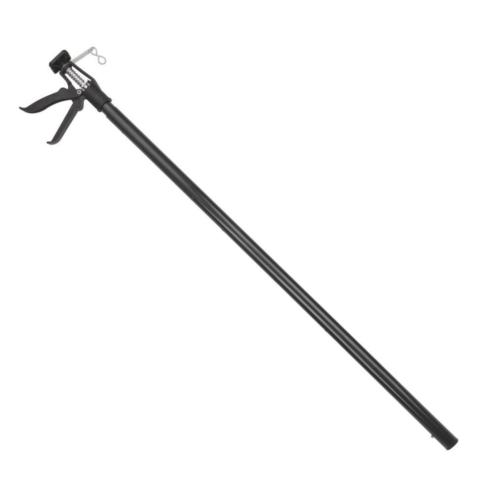

Maybe use something like this, if it is occasional use. Rated to 40 kg each.
Not seen one being used so can’t recommend but several companies sell this type of prop
This is a quite cheap solution. Nice one, haven't seen this before! I used to use a telescopic barn painter device in the past. Then I bought an extremely lightweight bike as a solution, but there is still some issues. It's hard to put the cover on the bike when it's so high, and there is too much wind resistance when driving with it on. And I always scratch the roof...
But would be nice to have laying around anyhow I suppose..
