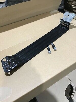

Spare wheel is no problem as the spare wheel is behind the rear wheel axle. The 4motion system is right in front of the spare wheel.
Thanks for picture. I have a 2020 ocean 4 motion bought without a spare wheel. Has anyone put in their own spare behind the rear drive if yes what size did you get in there 17 inch or 18 inch ?
I've got an 18" spare wheel with a 235/55/18 104V tyre that fits OK into the rack.
Alloy VW 18x7.5" rim Durban style as used on the VW Amorak.
Available if anyone needs one as I decided to stay with 17" rims.

Thanks for reply. I first need a confirmation if I can fit a rack and a wheel and tyre under my van
I think l'm correct, but if you order 18" wheels as a factory option, you don't get a spare wheel (or carrier). I've never understood why, because surely the overall size must be the same as 17"wheels. You say your 18" Amrock wheel fits in the cage, therefore why don't VW supply a spare with 18" wheels?
I’d always assumed it was because the 18” wheels were also wider but since BJG says his fit into the rack it’s a mystery.
I think the regular 18s from the factory are 255 width. But BJG is using a 235 width same as the 17s which must fit.
Think I would be happy to run a slightly narrower tyre as a spare. I have the removable tow bar so any idea if that compounds the problem ?
They use the wider 8" rim and 255 tyre which would be a problem with ground clearance. That's why I tried the 7.5" rim and 235 tyre but went to 55 profile to get load rating up to 104. 235/50/18 101 tyres available but below the original 103 load rating.
Towbar has no impact on spare wheel fitment.
