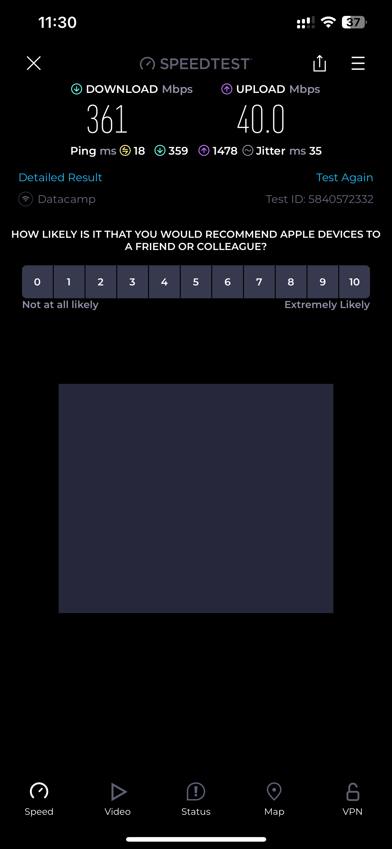

The solution I chose is a home router that can be run off 12v in the van. On 4G I have seen download speeds well over 200mbps and uploads of over 100mbps. I have also tested it twice when visiting friends in non-5G areas. I could not get a 5G reception on a new iPhone 15, however the router connected to 5G without issues, so the internal antennas are pretty effective.
For me, it works as a solution I can use whenever I need it. I just plug it in and about 30 seconds later I’m up and running. You can also mod this router to give 4x4 + 2x2 MIMO when using external antenna. However, this makes it a much more expensive solution and I doubt the performance benefits would be hugely significant.

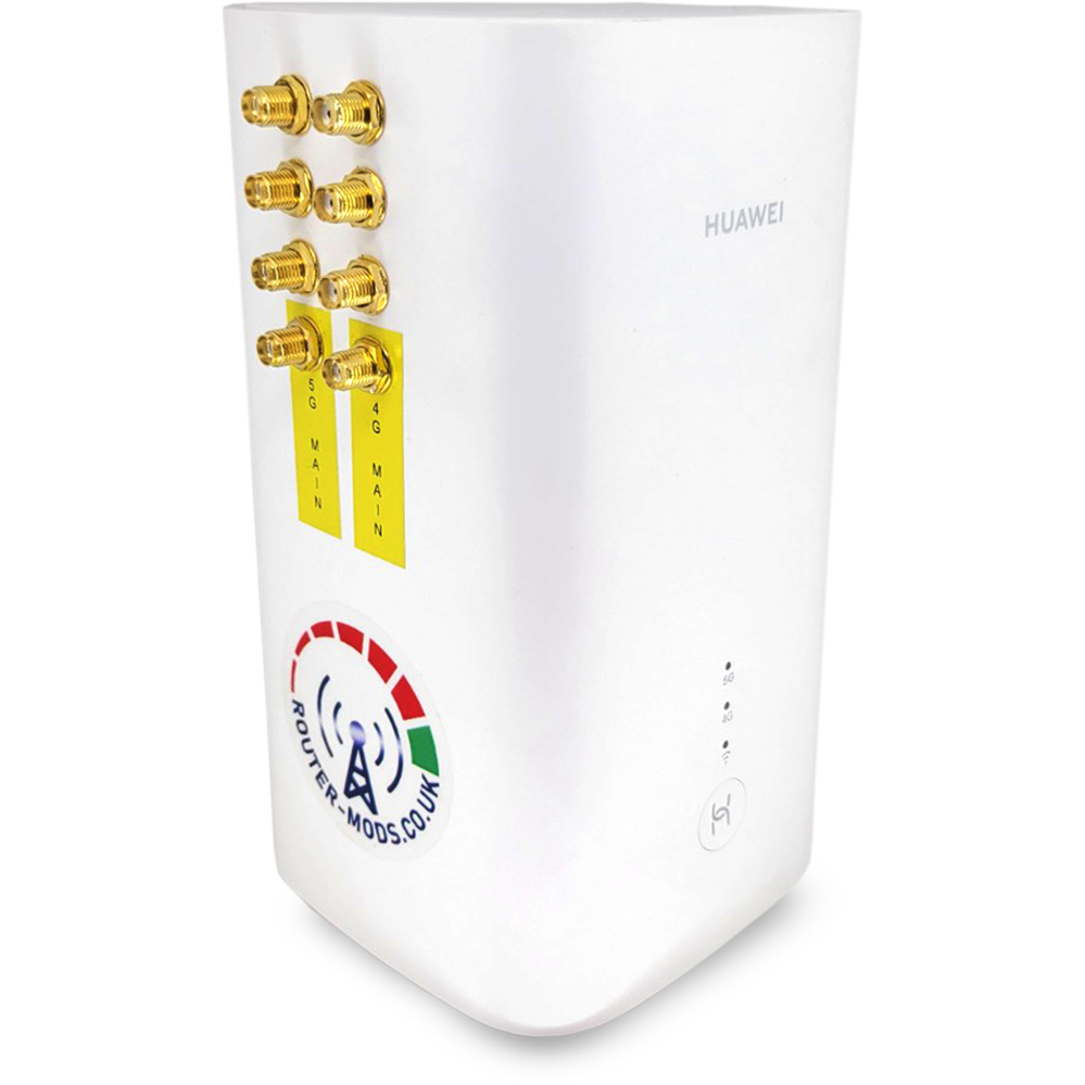

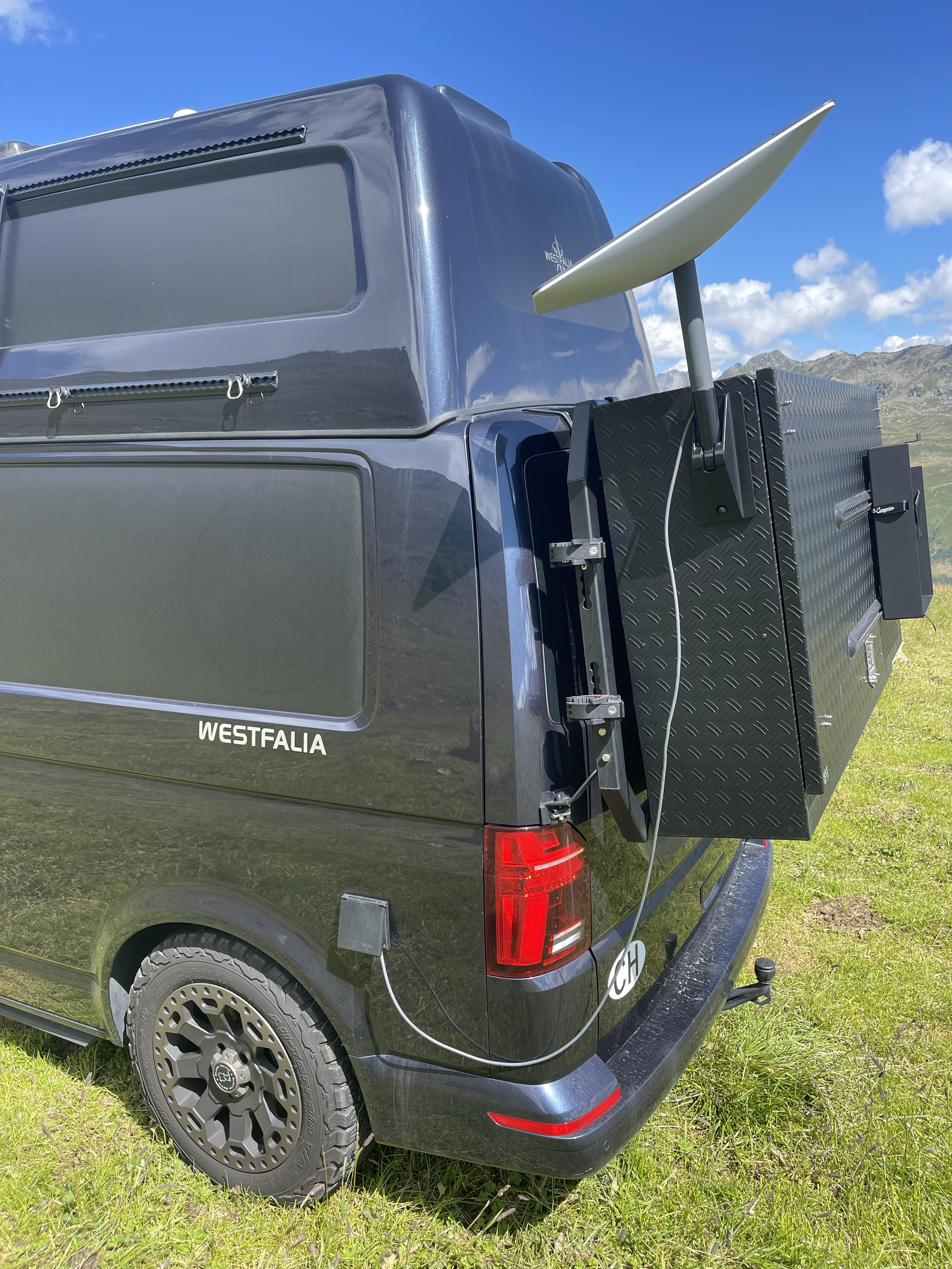

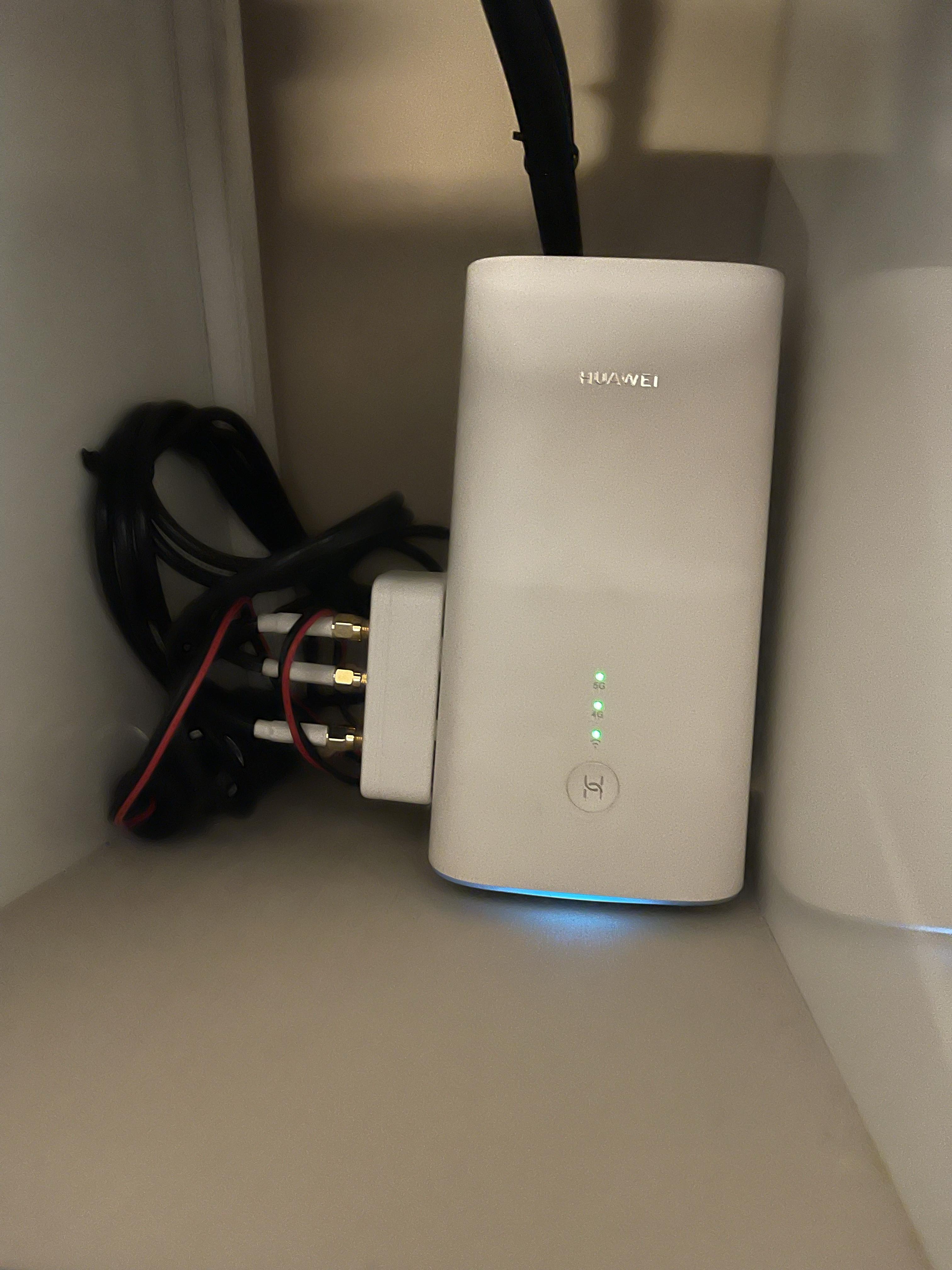

Can’t complain here. Huawei 5G CPE 2 Pro with 12v cable customized by FTS Hennig to use a 6X6 MIMO external antenna. This is a pricey unit but gets the job done superbly. If you need reliable connectivity and work from van daily! I also have a backup connection via the WAN port to use Starlink if I’m using it in the middle of nowhere. Note this is on my Club Joker Highroof and not a Cali:
Impressive spec! I’ve never seen a 6x6 MIMO vehicle antenna before!
What is the antenna you have?
