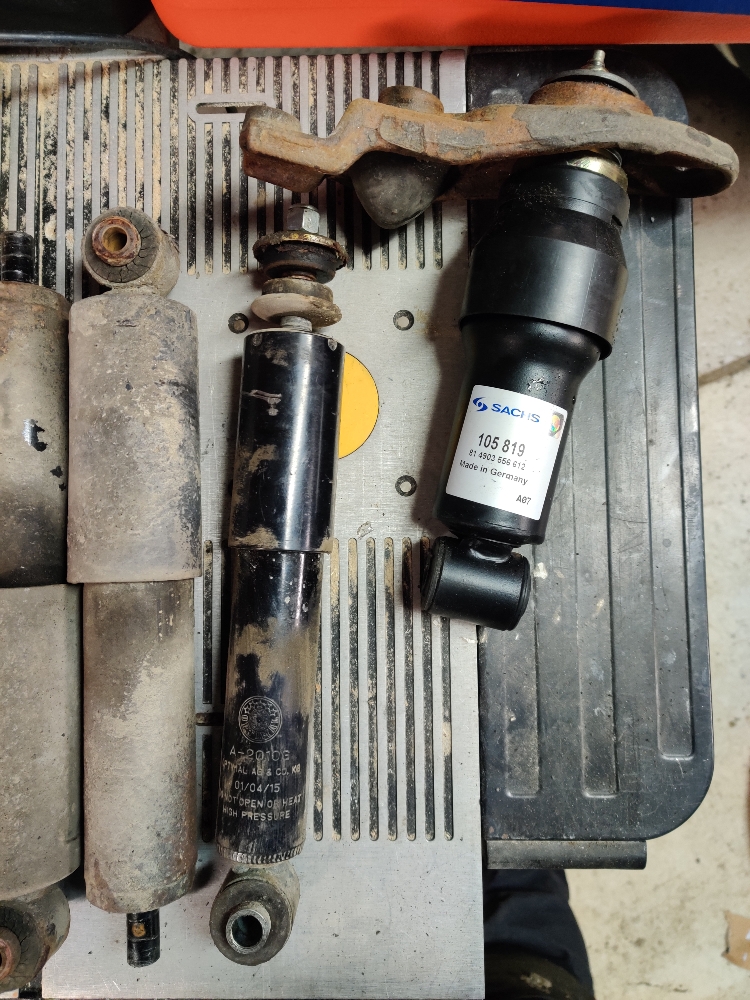

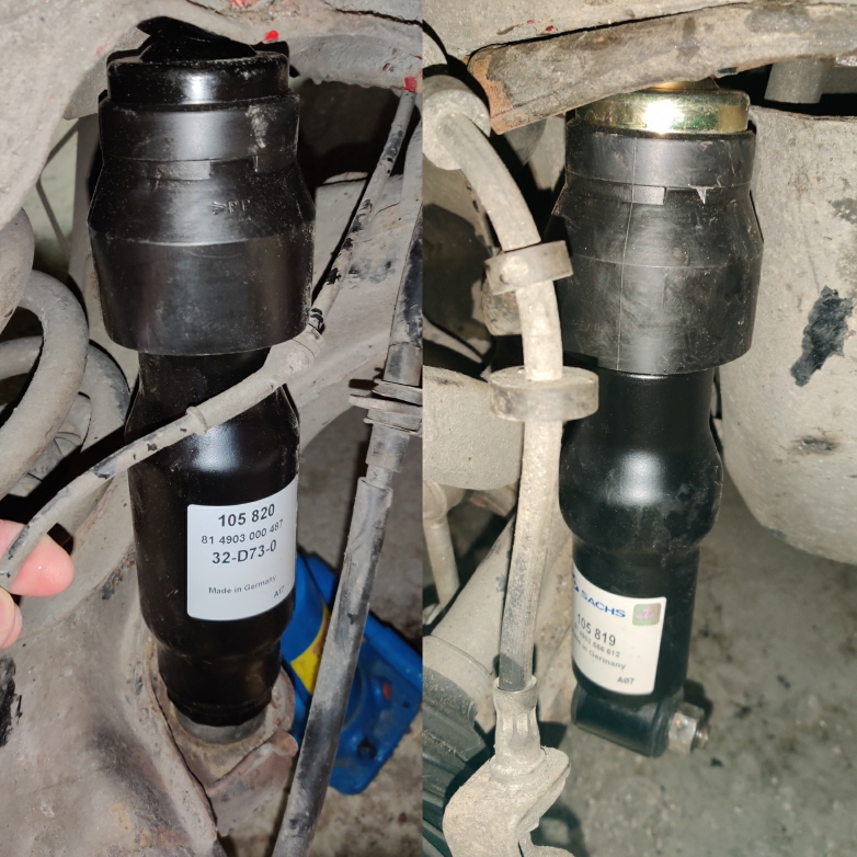

I finally got my Sachs shocks fitted. I've only test drove them for a couple of miles so far but they've made a big difference the roly-poly ride. The shocks I took off looked the same I had fitted to my Syncro when they were changed in Norway and they lasted 5 minutes! Hopefully, these ones will last a lot longer!
