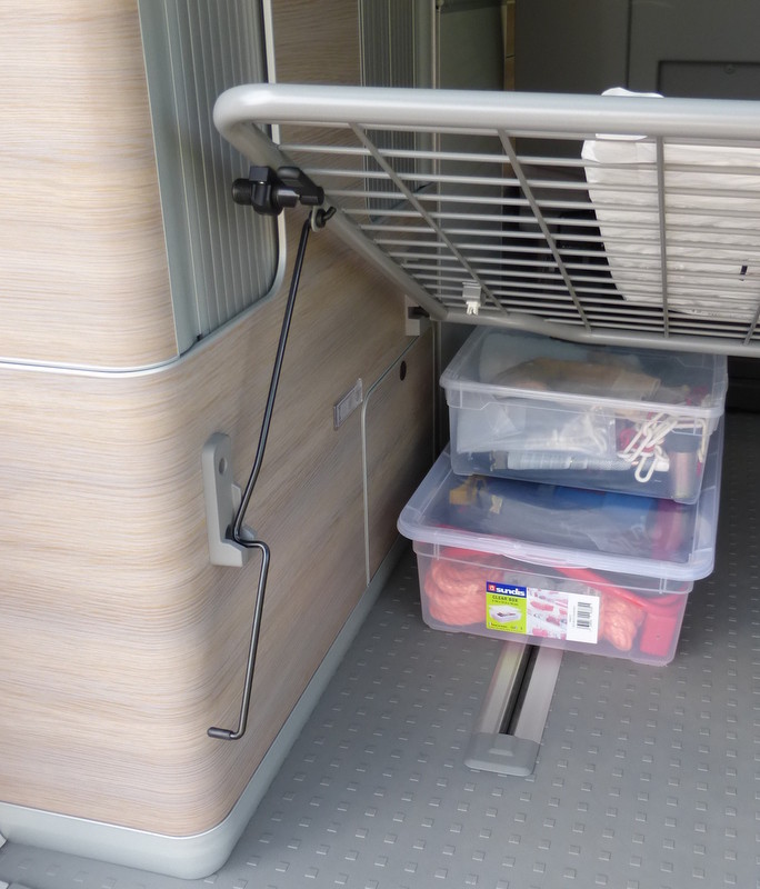

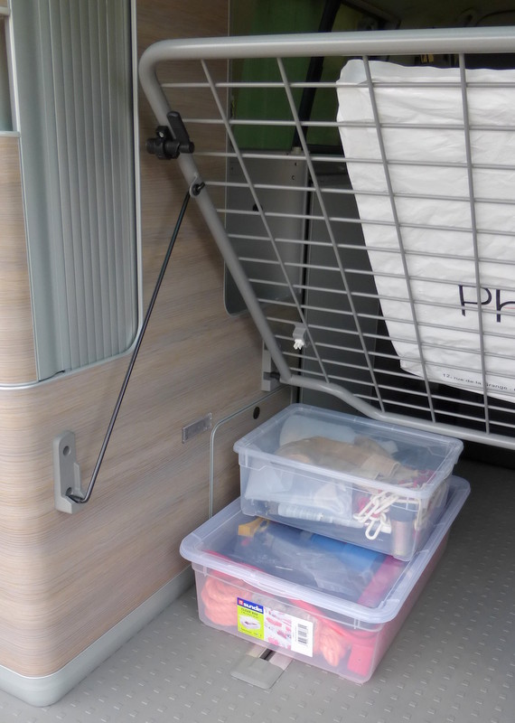

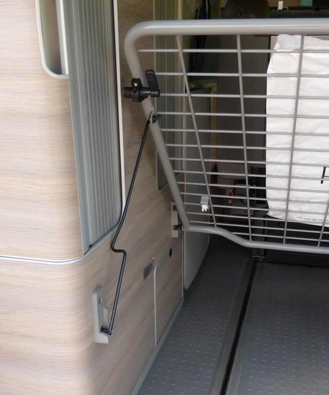

I finally got around to fixing my problem.
This is the original prop and the plastic boxes which get crushed by the front edge of the shelf if you raise it that far.
This is the newly-bent prop which allows lifting the shelf far enough for easy access without damaging the boxes.
There is still a highish position if required.
And it still clips in the original retainer...
So I can cross that one off the list!
Very interested in this modification.
How did you put the new bend in the prop without snapping it or damaging the plastic coating?
