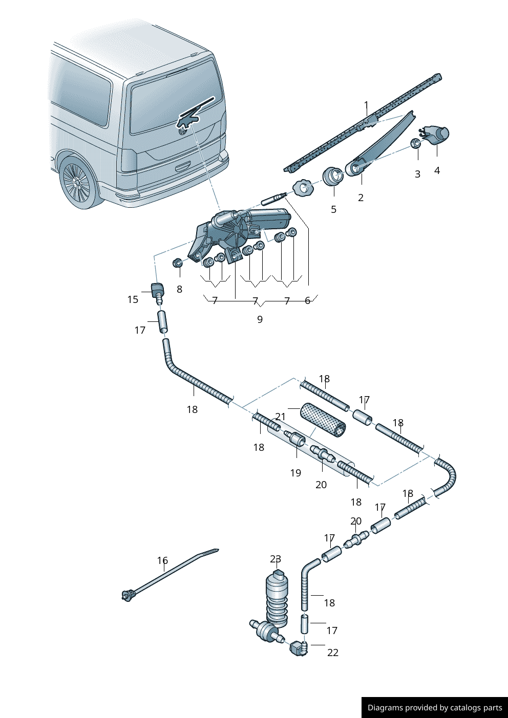

This might help

PS the corrugated tubing VW use has connecters along that run.
I would say the leak is at one of the joints. For some reason Volkswagen, Audi and others use short bits of tubing with joints to make up the run.
It might be better as jts46 states to run a complete new tube.
