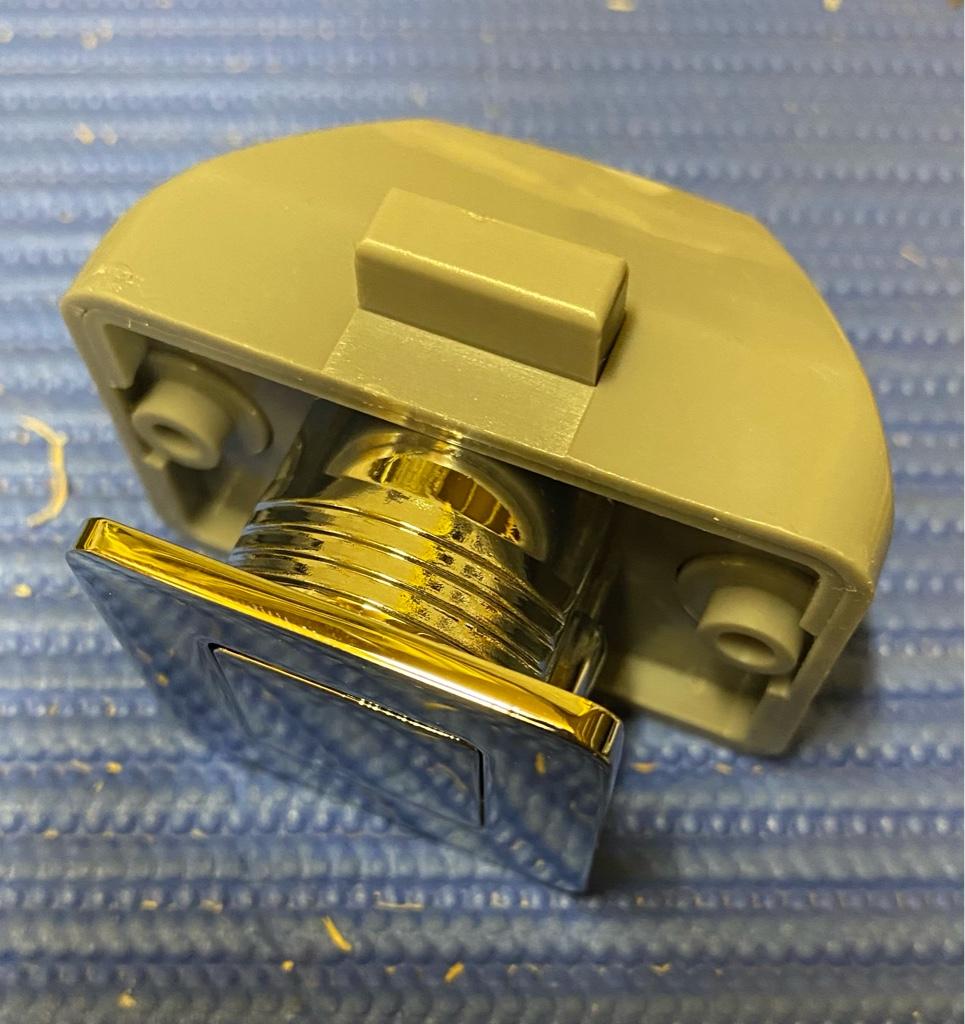

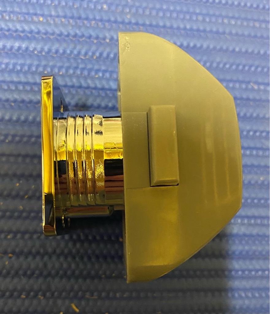

Two of the catches on the lower cupboards on my GC broke. I found it really difficult to find like for like replacements. Eventually I found the following at high peak conversions (I had to use google image search and a lot of scrolling to find them - it wasn’t easy to find, hence posting here in case of use to someone else).
The chrome part is polished rather than satin, but the catch mechanism itself is exactly the same and worked perfectly (same bolt centres, throw, etc). A 2 minute replacement job which avoided a visit to the dealer, albeit at a small cost.
FYI I also found the satin version on a US website and on a HK web site, both from marine suppliers and at higher prices, but as it’s incredibly unlikely that the button itself would actually need replacing, am not posting here.
(Ignore the yellow colour cast on the photos - they are a match - photos were taken under garage strip light)

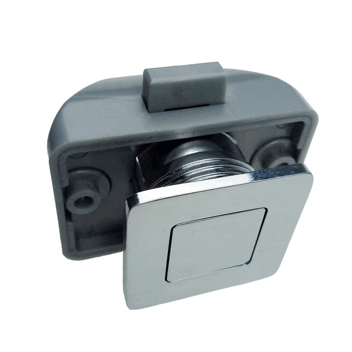

Chrome Square flush fit push Lock - High peak Conversions
These new design Square push locks are an a very attractive alternative to the traditional mini push lock. Great for the new modern look in your Motorhome / Campervan or Caravan.
