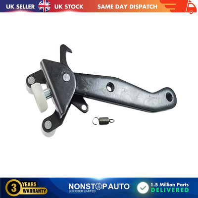

I fitted this one when mine exploded in 2019:
Seems to have done the job, although I don't think the quality is probably as good as the genuine part. Having said that, the VW one obviously wasn't that great either! Took about an hour to fit, if I remember rightly. You just need some blocks with padding on top to rest the door on when you take the old roller off.
I followed markh advice and have bought the replacement part from Ebay but haven't had chance to fit yet, hoping to have some time in coming days to try.

Finally got round to fitting the replacement part, it was relatively straight forward and made easier with second pair of eyes/hands from fellow campervan owning friend. Everything works but just not running with OEM precision - not sure if this is small variation in aftermarket part or overall wear and tear in the whole door system...I don't think I can get it running better, need to decide if I ask dealer to investigate when it goes in for imminent service...
For info, in case of future searches. Worth noting that the 2016 model has the little hook to attached to clip the door open. it's released via a cable attached to the door handle. I had the same experience. bought the £15 one from eBay. fitting was simple enough but it couldn't manage the weight and the hook wouldn't engage so that the door was clipped open. Bought and fitted the whole VW kit (£160) and worked perfectly.
