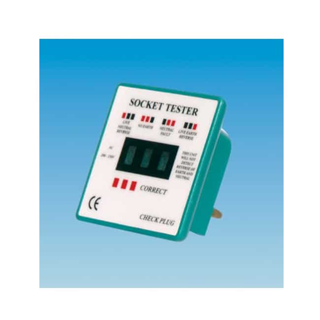

If you want to be totally free of worry get one on these polarity checkers and an adaptor. (sorry I could only find the checker on the at the club shop.
If the polarity checker shows reverse polarity then use the adaptor.
