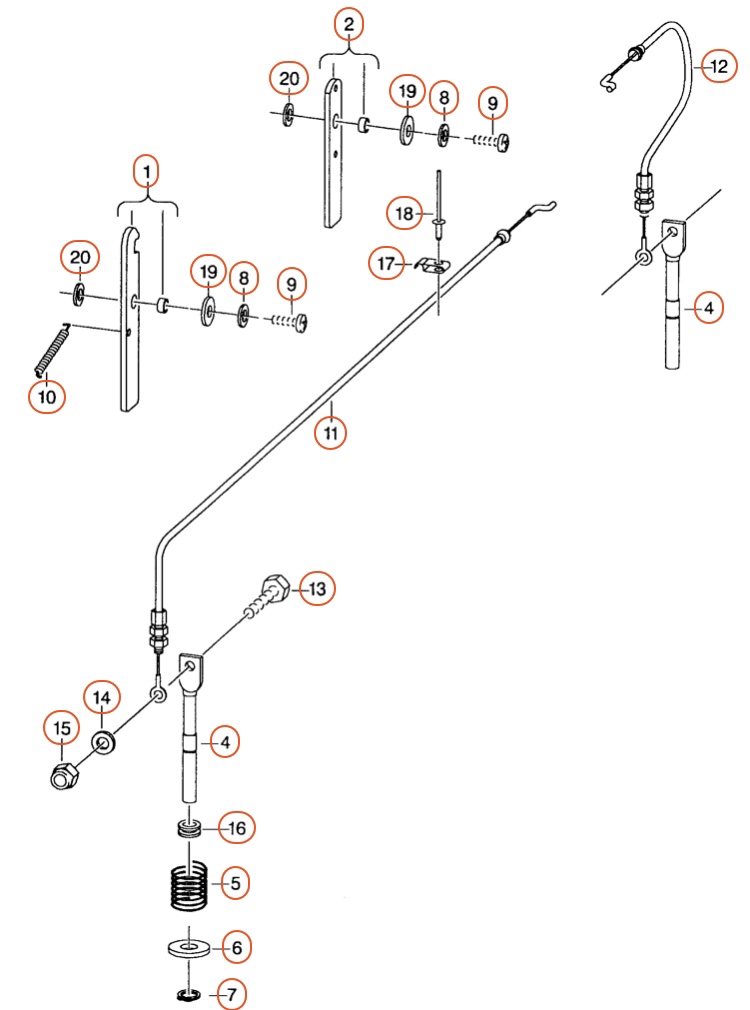

Hello. Seems it’s made up of two parts (11 and 12 in the diagram), do you know which is broken?
The bent bit of metal that goes through the operating handle has snapped off the end of the cable
