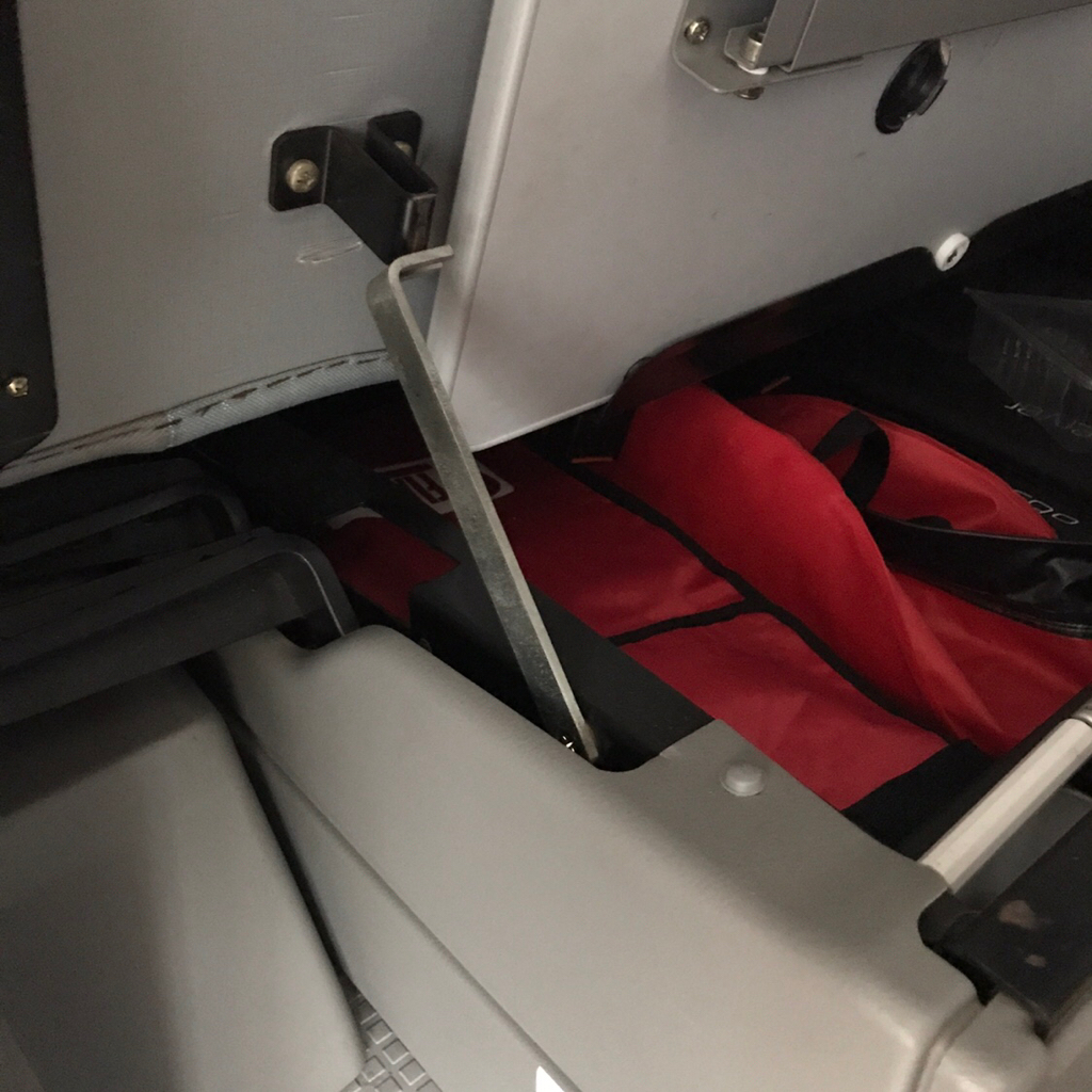

On ours to the left there's a metal strut that you pull up from the base and use to hold up the seat base.
What year is your van?
I'll have to take a look for that when I'm back this evening, I haven't noticed it before, though I could have missed it. Our van is 1993.

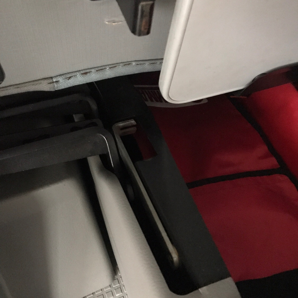

Thanks for the help. Found it, but mine is on the other side for some reason. Will be much handier now I know where it is, thanks!
The stay on mine is on the right as well - a 1996 California. It must be another one the little changes made by Westfalia over the years.
