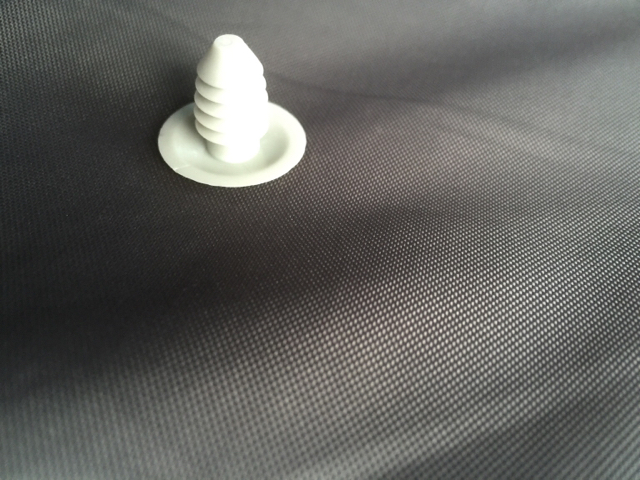

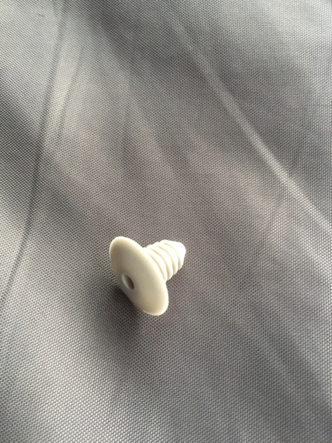

Hi all, just received some roof liner retaining grommets from the dealer as one of mine had broken. Either this had caught on the bellows zip of the ribs that are sewn in. All you have to do is line it up and either push in (if you have a strong thumb) or give it a little tap with your weapon of choice.
Thought I'd share in case anyone else finds one broken but I think it's probably an isolated occurrence.

Not unknown on the T5.:thumb

Old thread - but i have found three of my near side fixing plugs have broken off. I have investigated the issue and reckon its to do with the bed construction. The fixings have broken on 'my' side of the bunk and not on my wife's side. it seems my additional weight when manoeuvring around the upper bed is putting pressure on the roof lining - through the mattress and the slats. The lining fixings are simple plastic lugs that break off if stressed.
Well the upper bed is only rated for a total of 150kgms weight, according to VW.
