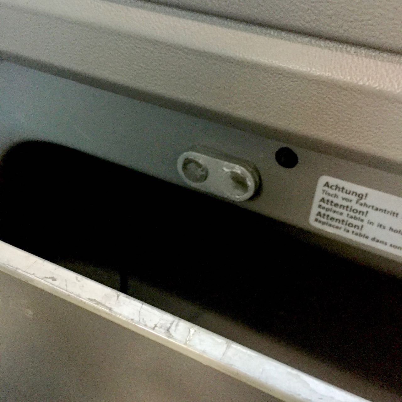

When I got my third-hand cali the table was in the back - because the catch was stuck. Tried to fix it and then did not try to get new parts because I thought the problem woud not be solved by a new catch.
I glued two super-magnets to the door and two small metal plates on the table. Side effect: no rattle from the table in the door.

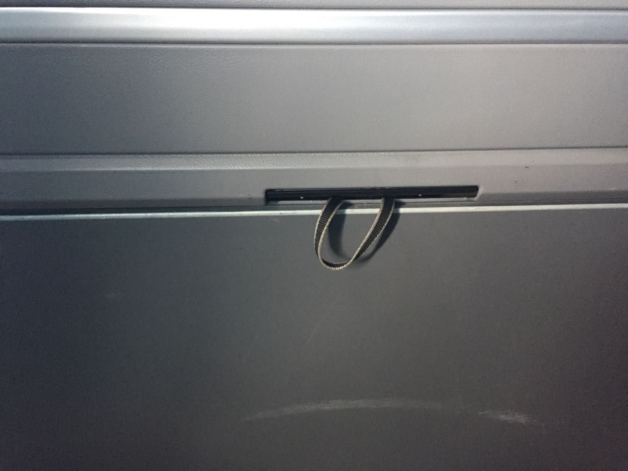

Removed the catch and riveted a strap to the table
Fixed the magnets with double sided TESA outdoor tape. These ugly old magnets are for 'testing'. Two shiny new magnets are on order.
