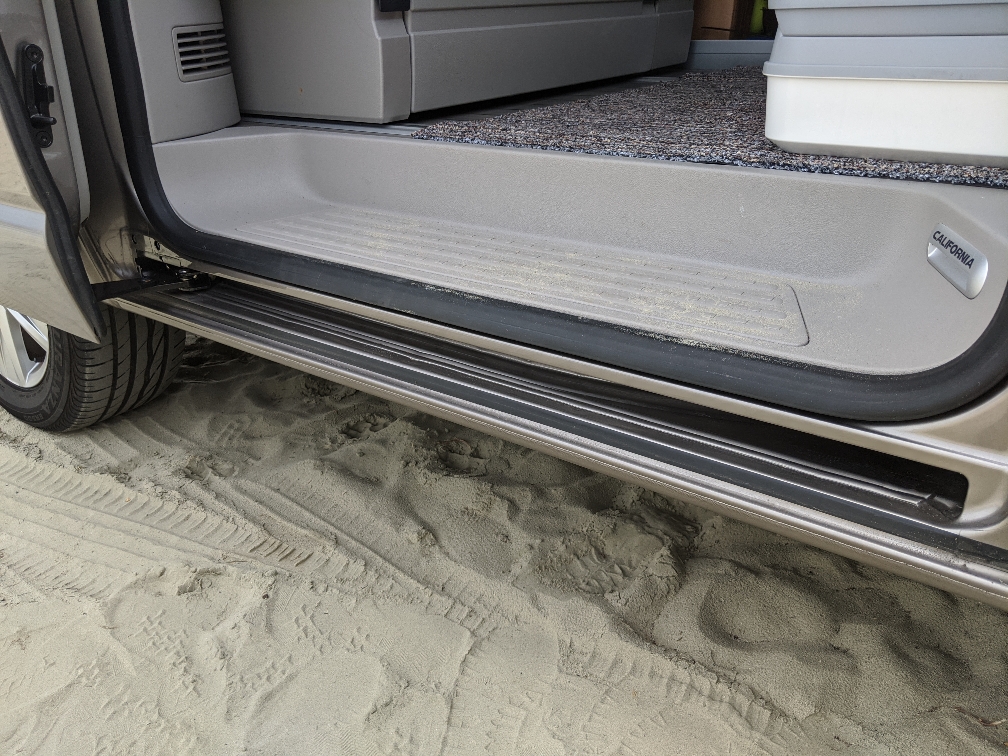

There seems to be some kind of a grease in the lower sliding door runners. What is it?
Personally I would get rid of any grease on the track. Probably the worst place you can park is where you are in the photo, on sand. As you get in/out of the van inevitably bits of grit etc will fall into the track creating a grinding paste. The runners are plastic so dont really need any lubrication between it and the track.
Agree. Better off dry. The white plastic wheel is meant to grip the track and turn, not slide along the track.
I believe you may be referring to the factory applied wax type material that can be seen at the edge of the sill ?
Is it opaque and waxy ?
I agree with Bri, it is supposed to be dry (maybe the dealer greased it for you) I clean mine with brake cleaner then add PTFE dry lubricant and rub dry with a cloth otherwise its a grit magnet.
Thanks Loz. Maybe it is dry PTFE. Will need to clean it as I can see some grime/dust there.
You see this in the rails of sliding doors , also on my 2012 Cali and my Renault Kangoo .
It's transparant to white color and looks more or less like candle wax .
Normal imo.
Just popped out to have a look at mine.
It’s not got any grease on it, but does have a whiteish strip, it’s like a rubberised PPF stuck on the track. I think it’s there so the wheel can grip it and turn rather than slide. Mine is a MY19 about 6 months old.
Posted that when I was at West Wittering beach today. Was windy, so had some sand get in there. Before closing the door, brushed it off with a 1" painters brush and it cleaned up well. Now back home, will clean as Loz recommended and then put some dry PTFE lubricant and then rub dry with a cloth.
Thank you all (esp Loz) for your inputs :thumb
When you wash your Cali open the door and clean the general area to remove any grit and grime, dry lube periodically
Make sure you vacuum the rubber seal where the sand has settled between the seal and the step.
And remove the build up off the roller as well.
