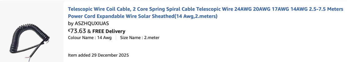

I’d really like to find a spiral cable with the proper gauge for the kit, as well as the type of mounting plates you have, instead of building a full DIY setup.
