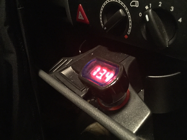

Hmm mine charges both batteries on hookup, this weekend on hookup I had 13.4 on the dash socket.
However it wasn't all the time.
