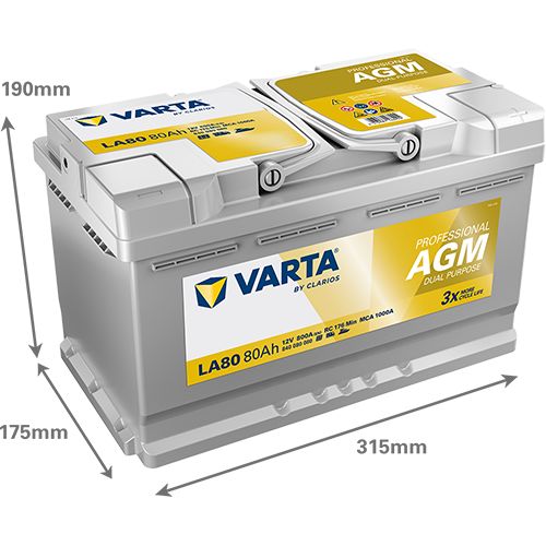

Looking at my own pair of factory leisure batteries and popping the bonnet open, the black AGM is the leisure battery and the white, starter.
I agree with welshGas, change both leisure simultaneously if your budget allows. If not, don't swap it out yet, wait until you have both leisure battery replacements.
Varta sell them directly for about £170 and is, as WelshGas mentioned, model: "LA80" AGM which may likely be cheaper than with VW.
