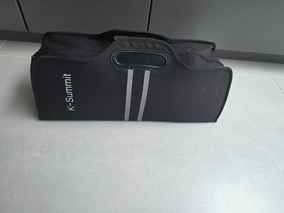

I also bought a set of unused Koenig Summmits
off eBay, £200.
Very easy to fit thanks to their design.
Easy to sell on again if needs be.
off eBay, £200.

So you can use the Koenig Summits on 255/45 R18 wheels (looking at your idea of using same size winter tyres fitted to current wheels) ? Are these the K44 size or the K 84 VAN size?
Mine are K44. Perfect fit on 255/45/18.
As stated in post #3, they don’t wrap over the inside of the tyre. Also clearance to wheel arch is fine, even with lowered -30mm springs.

FYI, chains fitted.
Worth noting if you do go for these, don’t over tighten the ratchet mechanism in the middle. It’s easy to bend.
Top tip. Before tightening the ratchet, push inwards towards the wheel at the centre then simply take up the slack with the ratchet.
