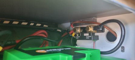

So it is. I haven’t seen any traces of a rear battery. But I might have to see what’s behind the walls. But anyway, my question is where the red cable connects, all the way to under the seat or, somewhere between. It’s not a big issue earth it and to draw the cables. I’m just wondering where to. I guess I need to connect it correctly where the N162 relay is fitted.

Great, thanks! Is that the N162 relay? And are the two red cables from front and rear leisure battery respectively?
It is. N162 relay is the split charge relay.
There is actually three cables, one is out of view. On the left hand side that’s the cable from the engine. The cable on the right hand side with the bare wire showing is one of the leisure battery cables. The other leisure battery cable is behind it. You can just make out a fabric sleeve on the bottom right of that photo. Both leisure battery cables are in that sleeve.
Photo below shows the three cables more clearly. Photo courtesy from a thread from Loz who made a post with instructions and photos showing how to change that split charge relay to a more modern dc-dc controller. Loz might have those speech bubbles the wrong way round. The cables that are together in the sleeve are from the leisure battery’s.
Great! This is info I’ve been searching for years(!). Now hopefully I know where to connect a rear leisure battery that was missing in my 2005SE Cali.
I’m not sure what you mean by ”…make out a fabric sleeve on the bottom right of that photo.”. Is it a function in the picture of the relay?
