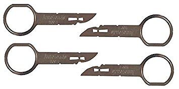

Did the same myself a month or so ago and yes, you need removal keys. Cheap and easy to get on eBay, I bought these but pretty sure they are standard things so any will do.
Slides to the left and you can then get to the quadlock on the back. Took me a while to work out how to get that off, the brown plug out and the new one in.....!
