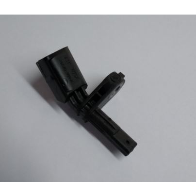

2017 Ocean with full VW service history. My tyre pressure warning light has started to appear on the dashboard which has slowly become ABS / ESP as well. I believe this is a faulty ABS sensor.
VW want a non-refundable £175 just to diagnose the issue !
I understand it costs time and therefore money to check it out but this is crazy.
I suggested I just book it in for a service where they would see the warning lights and resolve the issue but, apparently, they would only do the items on a standard service list and return it with the faults unless I pay the additional £175.
Probably time to do it myself or go to an independent specialist.
Cost us £90 at a local garage to get sensor checked, swapped & test drive after. Any garage can do it, no need to find a VW specialist. Most cars have ABS sensors so they are not unique to VW.
It’s worth buying a Carista diagnostic dongle and then you can self diagnose, as it will tell you which sensor is faulty.
Just for your information ATE are the OEM for the ABS sensors although you can buy cheaper. Here are some links based on a 2017 T6 Beach 150 but should be the same for yours.
VW prices are very expensive.
Same original part from LLL parts.
Please note that the sensors are handed so the part number will change depending on what side you need.

I’ve just replaced my NSR ABS sensor and I can assure you it’s easy. You need to find out which one is faulty first via Carista or similar. Maybe someone locally can help?
Then it’s a half hour job and the sensor is 15-20 depending on where you buy. Search my threads and you’ll see a recent post about it. Lots of YouTube tutorials too.

Agree. I went to buy 4 abs sensors and they said are you sure....go on how much....£95+VAT each.....you're taking the biscuit on that one. They then suggested that they could diagnose the bad ABS sensor and replace that one but that was £150 to verfiy which one. I said I can do the same in about 5mins and declined.
Left front for me on the VCDS. Left it for a while and then replaced one day in the drizzle. I was lucky, as it took me longer to remove and refit the wheel then replacing the sensor. The rest have been fine
Blimey....£27 and circa 15mins. But I did put a Bosch one in rather than the 3rd party supplied VW ones at inflated prices.
I decided to not risk a cheap one, spent £10.60p on a brass bushed version. The quality of the vw genuine is really poor. Mine had failed because of water ingress.

Part 1 of my fix is complete, I bought a Carista scanner which has confirmed both rear ABS sensors are faulty.
Now I have to source replacement sensors and swap them out.

I’d change all four while you’re doing the job. Had all of them changed by my local tyre fitters for £125, the left rear was a nightmare, drill out job.
They’re all the same age, the failure of the others probably won’t be far behind. The op already has 50% failure. Get all the hassle out of the way in one go.
maybe…the thing is that each corner is an unrelated job so you may as well just wait to see IF it goes. If you had a bulb go, you wouldn’t change all the others.
NSR seems to be particularly prone to failure, I don’t know why.
