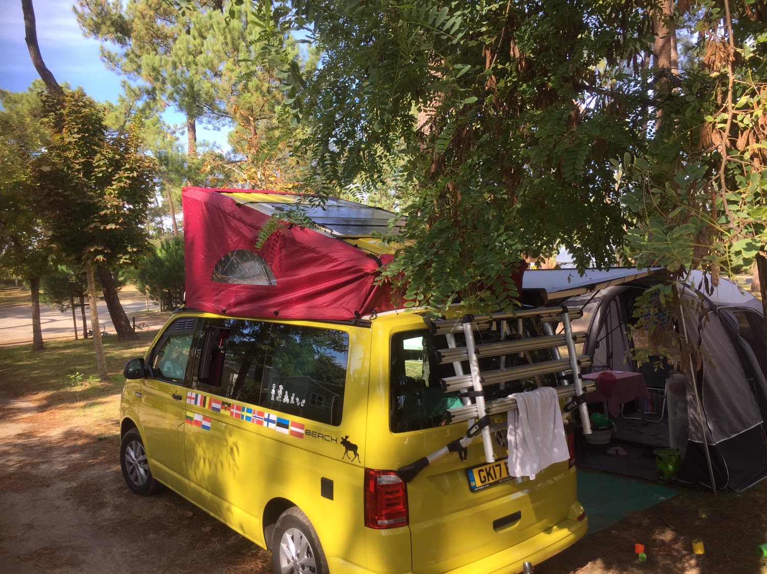

I think I have found the cause of the problem - the leisure battery not sufficiently charging from the solar panels in the shade of the trees. Leaving behind the hookup cable is looking like a very poor choice!
I turned on the engine, to frowns from other campers, and the fridge works just fine.
Picture showing the probable root cause of the fridge failure.
