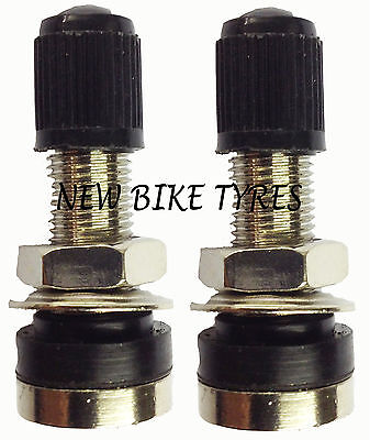

Air pressure, main tank/shower by an air compressor and he uses a simple tyre valve fitted to the can lid and a bike hand pump to pressurise it.
Low tech wins out.

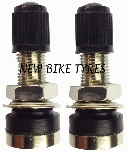

Possibly use this type on can cap
