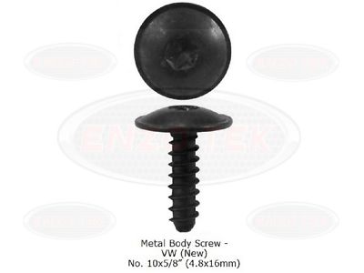

Do you know what type of fixation is needed to reattach it?
This seem to be a frequent problem. I had it in the first few months, and my son has the same problem on his Multivan.
Apparently Wesel it’s a self-tapping screw but I haven’t checked the size yet.
These I think?
