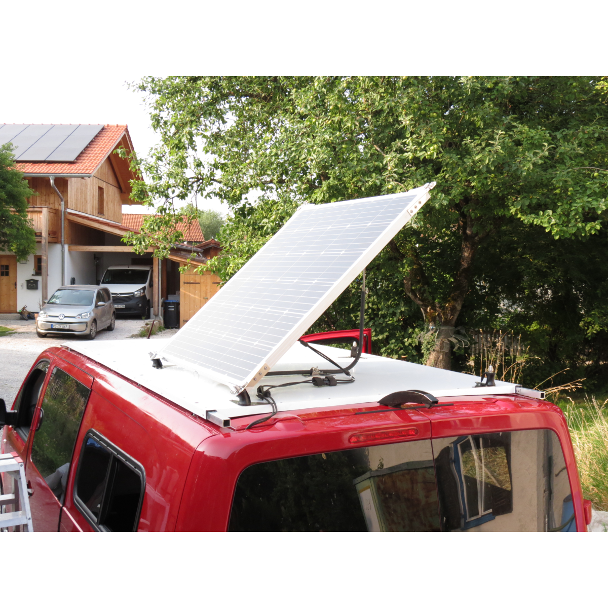

Thanks! It’s been quite a project to build mine. I’ve learned a ton and my end goal was to build a fully off grid van. It’s now pretty much there, with the exception of 2 to 2.5 months a year (December to mid February) when solar is a struggle. My new BougeRV CIGS panels really help there with 48 bypass diodes per panel to eliminate shading issues, but the angle of the winter sun is still an issue.
If I were to start over with a limited budget my order of priority would be:
1) Replace leisure batteries with 2*100Ah Lithium Phosphate heated batts.
2) Add Victron DC-DC charger for quick charging with alternator.
3) Have a Type 2 Mennekes to CEE 16A adaptor to charge at any AC EV charging station
4) Install a Victron MPPT and start with an external solar panel to use on demand. When budget allows install CIGS panels on the roof
I’ve done all that and more with no mine but it was a lot of trial and changing/upgrading along the way. Read my build thread for more!
I would personally never accept having 2 different size leisure batteries. Thats a joke from Westfalia if true.

If I ever had a joker again I would get a bespoke roof rack rails made to fit the existing roof mounting points (front and rear). Then get solar mounted to it (possibly tilt up panels) and slide along..
I noticed a massive difference with that solbian panel mounted on a frame.
Not a fan of stick on, but you do have a great set up.
I was always off grid had 3yrs and a bit of full time in my silver t6 joker.
Enjoy:thumb
This mount might interest you!
