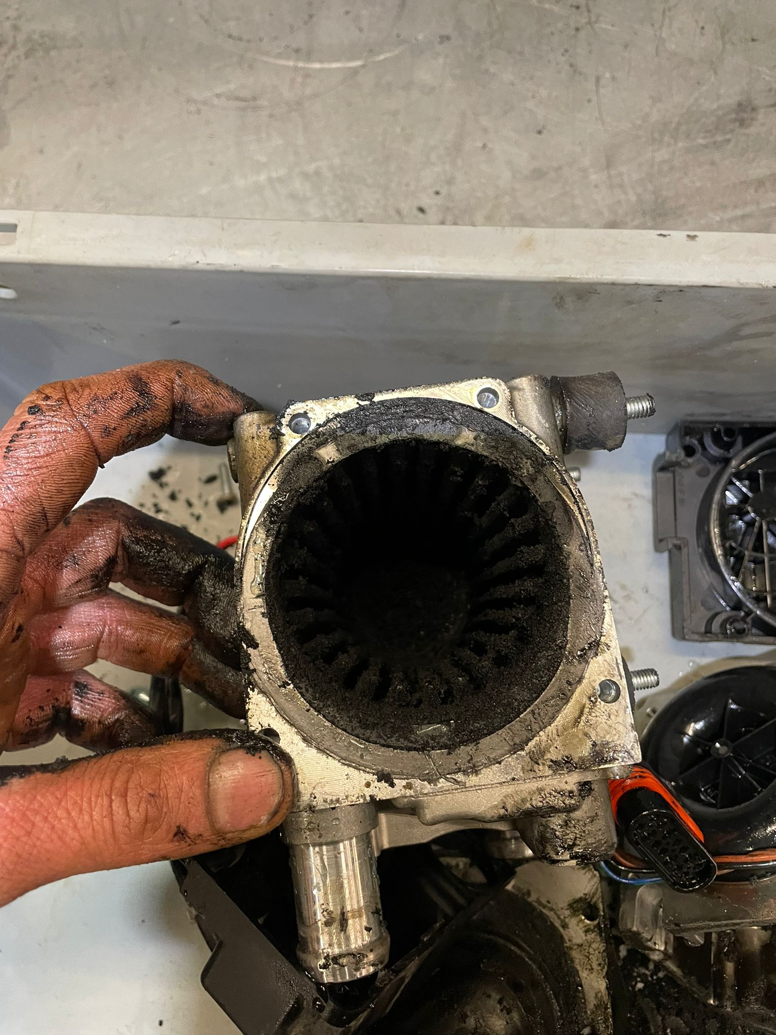

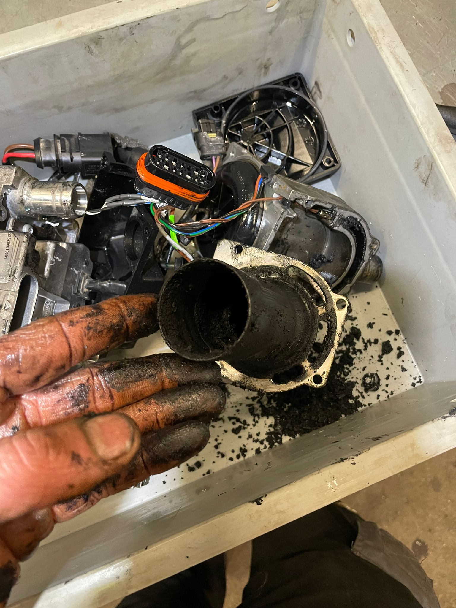

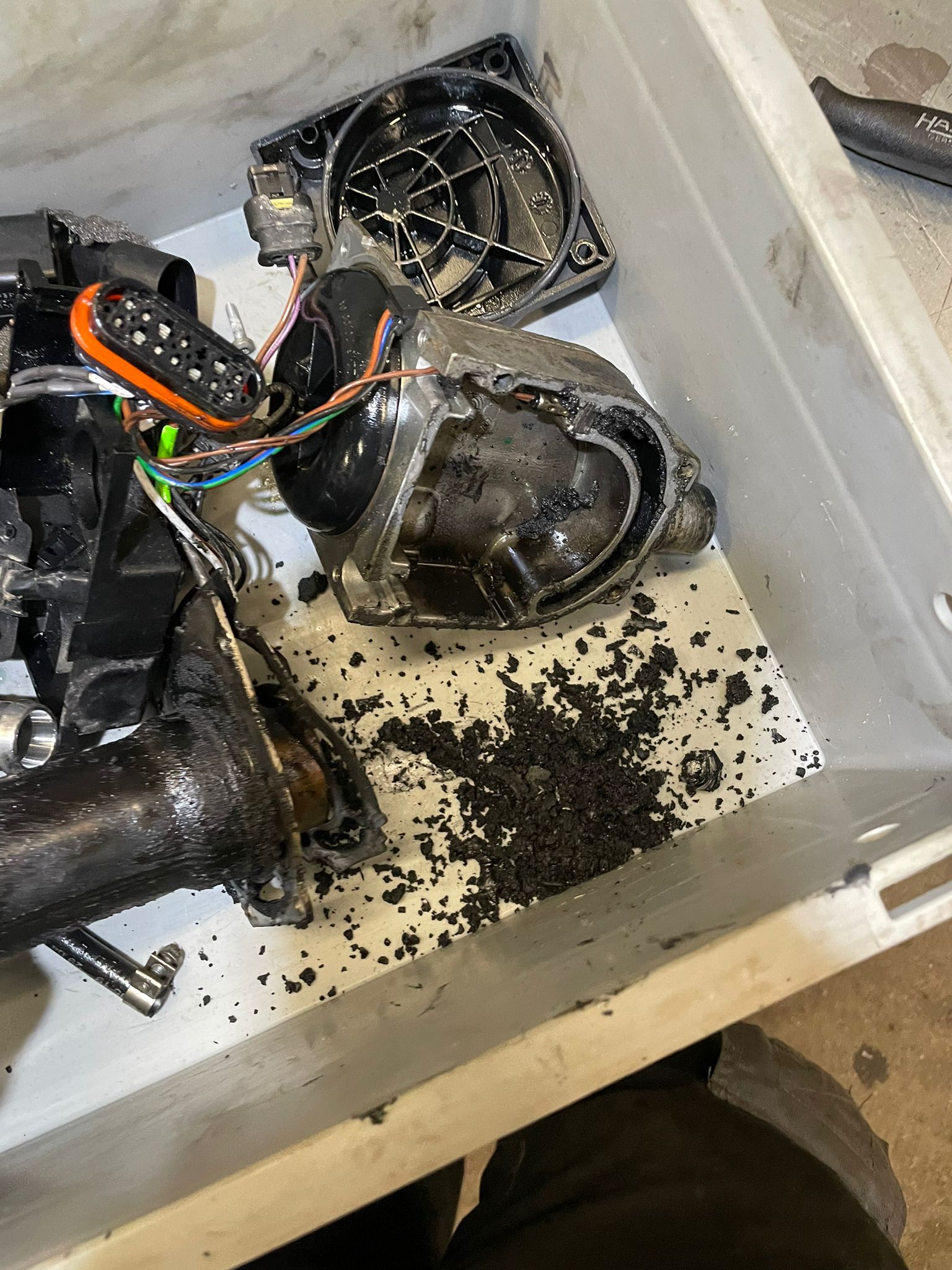

One thing I would suggest is running the heater on high for 30 minutes a month to keep it in good working order. Otherwise you can get carbon buildup and such. Even do mine in summer!
Cleaning the heater is no fun:
You’ll be perfectly fine! Enjoy the van and don’t over think things. Even in my Tesla’s I had to deal with delivery issues. Panel gaps, rattles, etc. deal with them when time allows.
Better get out and run my heater!

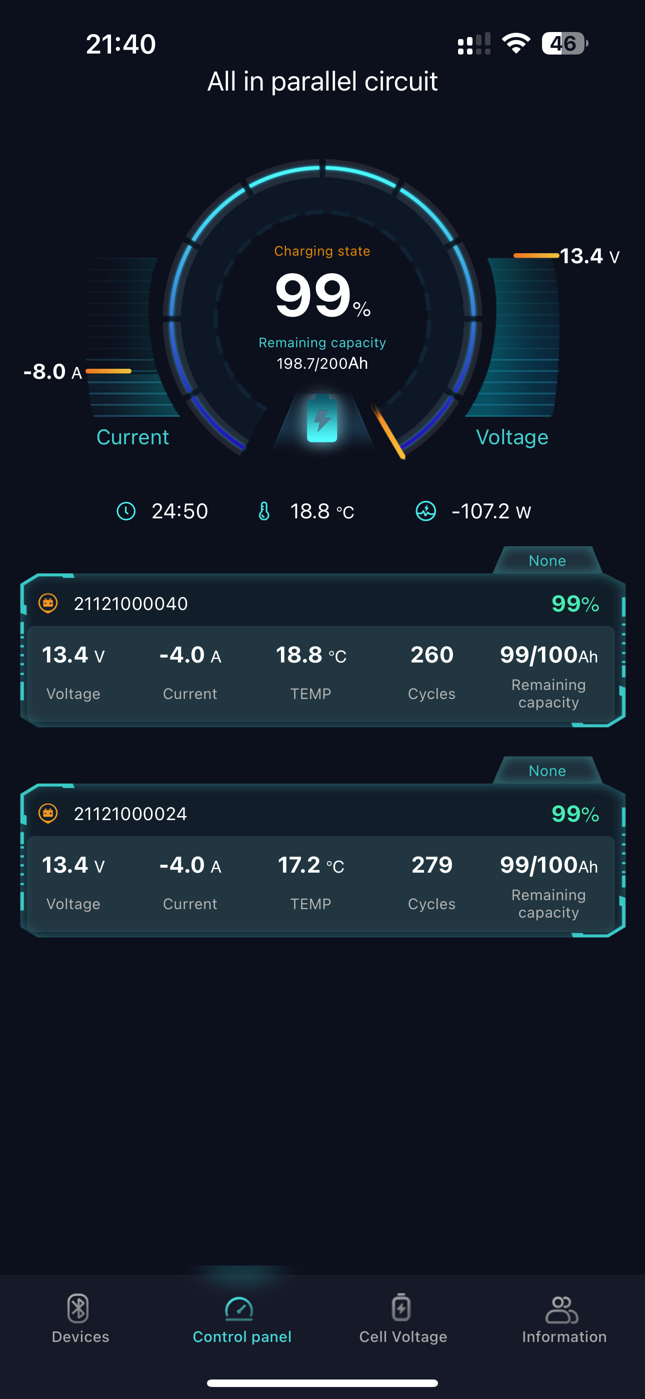

Further to my battery concerns as above, I would appreciate comments on 2 issues:
1) The batteries are Start Stop AGMs. I appreciate that these will work but are they to be recommended for "house" batteries?
2) After little use of my Joker in the last couple of weeks, the 70Ah battery voltage had dropped to 11.7v, the 90Ah battery showed 12.54v.
Hooking up to EHU increased the 70Ah battery to 12.8v, the 90Ah battery remained at 12.54v.
The voltage across the terminals whilst being charged on both EHU and vehicle alternator showed 13.4v across the 70Ah battery and 12.54v across the 90Ah battery.
Using the "house" electrics (off EHU) dropped the voltage on the 70Ah battery but left the 90Ah battery unchanged.
Are there some clever electronics involved here that flattens one battery before involving the other in both charging and discharging?
Or has there been a slip up in the wiring?
Thanks.
Phil
I haven’t seen the wiring diagram for the charging circuit but I’d assume that the two leisure batteries were just fed directly, in parallel with no circuitry between them. If that’s the case are you disconnecting them to take their individual voltages?
This is what perfect balance looks like. Pulling 108 watts, amps across batts equal for the most part so load is spread. Perfect harmony.
All I'm doing is measuring the voltages of each battery separately.
The console/panel just gives a reading for the main, 70Ah battery which is the same as my voltmeter reading. With lights and fridge on, to repeat myself, again, only the voltage on the 70Ah battery drops.
Whilst charging, the charging voltage is measurable only on the 70Ah battery.
To my non-expert eye, it would appear that the 95Ah battery is just a passenger and a non-contributing one at that.
Is there any other possible explanation than that it is not wired up properly?
