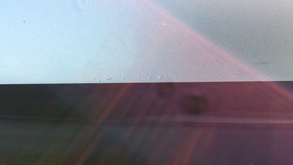

Just took a peek under the seal on the lifting section of the roof on the loan Cali while mine is being repaired. It's a march registered 2015 and it has bubbling on both sides.
Another one for them to repair!
Does any T6 owner dare to look under the seal....?
