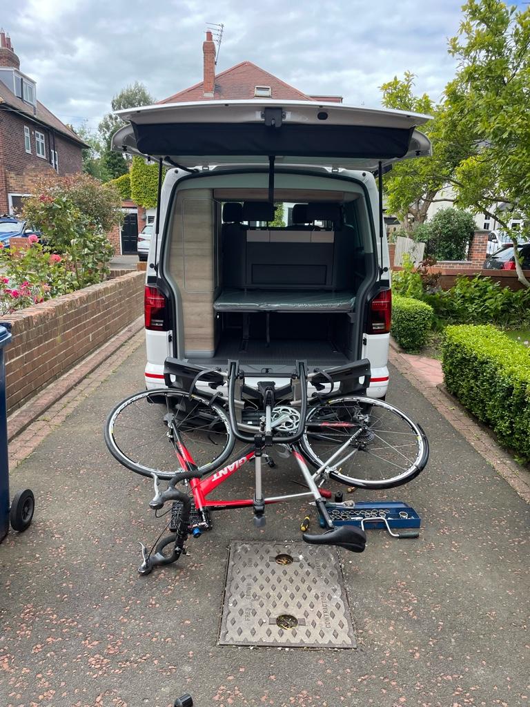

The Thule Easyfold XT2 DOES WORK right out of the box. You don't need to do any DIY. But, you need to drop the tow bar ball hitch to the lowest setting on the tow bar. There are usually four holes in the tow bar mount so mount the ball to the lowest two hole settings. Secondly, when mounting the XT2 put downward pressure on the carrier to ensure it is not tilted toward the tailgate. There is minimal clearance (2mm) out of the box and if the XT2 has any tilt toward the tailgate, the tailgate, when raised, will not clear the carrier. Lastly, use a 10mm spacer in the tow bar and that will allow significant clearance between the tailgate and the XT2. I don't call any of the above DIY unless you call turning a couple of bolts DIY, but it is pretty easy to do.

I have just bought the Thule Easyfold XT3 and can confirm it does not work right out the box.
It does work however, with a 5 minutes modification to remove the stoppers.

Jumping in here @dgbeale . I have a Thule Velospace XT3 and it does work out of the box. However, if one wants to ensure the tailgate can fully open with bikes loaded, then the wire cables that limit the amount of tilt need to be moved to the second position (holes for this are already in the frame of the rack). Simple 5 minute job. No cutting required as suggested above by @TheRellims ??

After removing the bolts I just used a series of increasing sized screw drivers to make a gap between the bung and the tubing and levered them out. One popped straight out the other took a little longer.

There probably isn’t a one size fits all solution as the height of the bike and width of the handle bars also need consideration. In most situations with tilting Thule racks or similar models my bet is having no bungs and gently resting the bikes on the ground will be the way to go.
Sorry to ressurect an old thread..... I have a Velospace XT 2 938 and I am unable to get the tailgate open on my '22 Ocean with a detachable Westfalia towbar. This rack does not have the rubber stoppers like the Easyfold and instead has some a wire cable on each side that are fitted with an allen screw/bolt and nut. If I remove these cables then it does rotate all the way parallel to the ground and the handle for the hitch is close but does not stop it from opening. On to my question, I do not have any other pre drilled holes as @GrumpyGranddad suggested. Does anyone have any advice/info or a possible solution to this? I've had a quick search and cannot find anyone that makes any custom length wire cables to allow it to move further back so the boot can open. For now I have removed these cables altogether but I feel like it might damage the rack as the weight of the rack is resting on a tube section when it is fully rotated. It works but not great.

Mine was the XT3 so did have the additional holes. Don’t know what the XT2 looks like but potentially you could tilt the rack to the desired position (testing on something to give required ground clearance) and then mark the position for the additional holes using the wires as a guide. Drill a hole each side to fix the cables and you should be fine. As I say I don’t know what the XT2 looks like.
