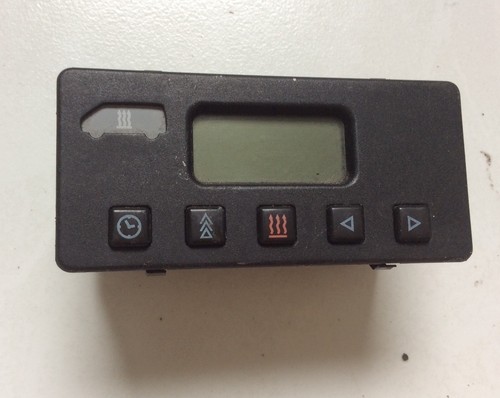

Still no info on how the heating system works; should the panel with the digital time light up as I can't see anything!!

You mean like this?

No like this

Yes that's what I have more or less
Ok, now I see.
Isn't there a way to get that panel out of the dashboard?
there might be a blown bulb behind the display, for the backlight?
Or if you have a part number, you might try to search this part?
Ok, now I see.

Hi tripplebee its bogey again , ihave taken out the old timer display and the bulb is fine and there is power there so it must mean the part is faulty but now I have the part number where do you think I could get one from
A quick search on Google for the part number 701963343 (A) gives me this:
12V/30min.
12V/120min (this is with suffic "A" like yours)
Maybe, if you open the unit (be careful not to break anything), it could be possible to repair?

Does the unit still work, so it's just the screen, or is the unit completely broken?

Yes it still works and yes it's just the screen!
The one without suffix is different.
Maybe if you can pry it open, you might see a bad soldering?
Are you able to pry it open without damaging anything?
Or you can wait after you order another one?
That may well be the problem. I’ve repaired the other of the two panels before due to dry solder.
I have the full VW workshop manuals for these. I’ll have a look later.
