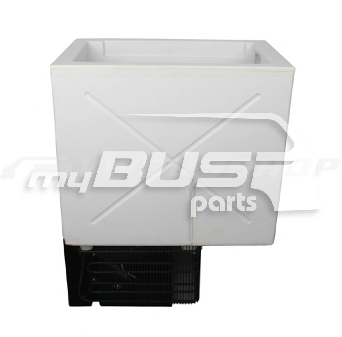

Basically one of these:
which runs to ~€950 these days. There are other vendors, such as Cool and Shop for a bit cheaper, and some guys in Poland.
To be clear - you purchased a near identical replacement, which needed to be positioned 2.5cm higher in the space under the counter and it has the same connectors as the original fridge.
