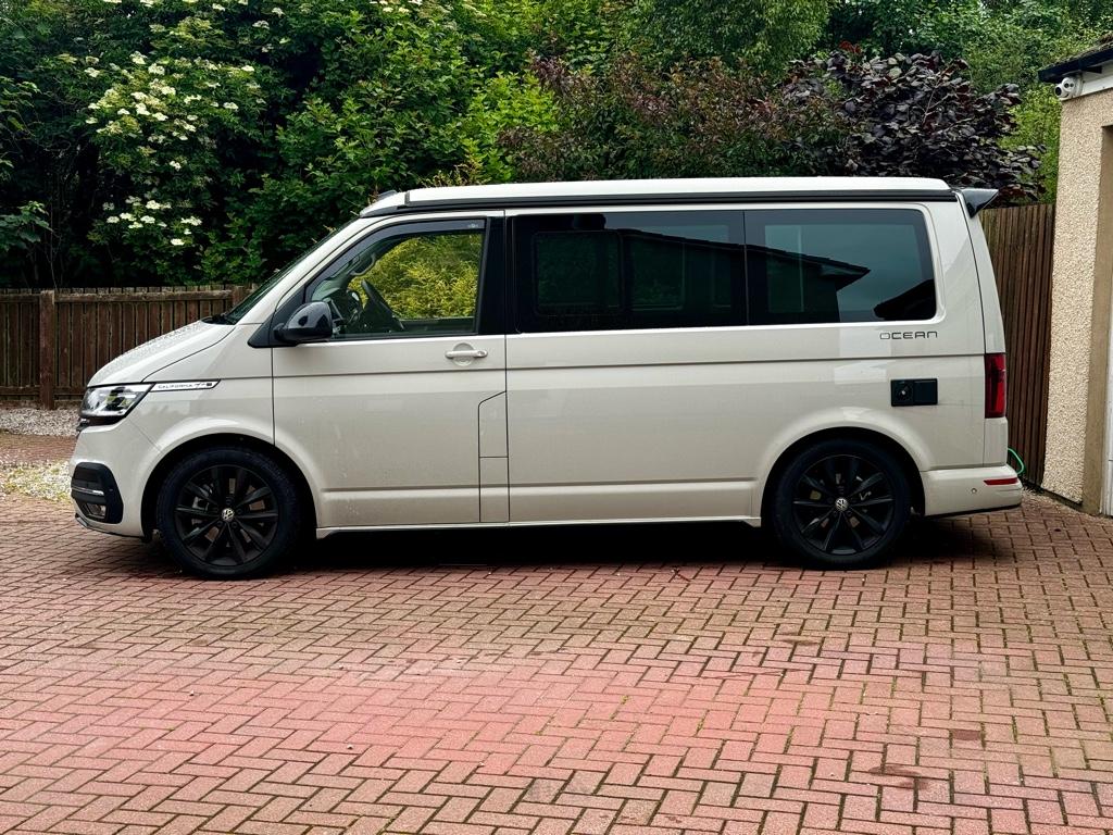

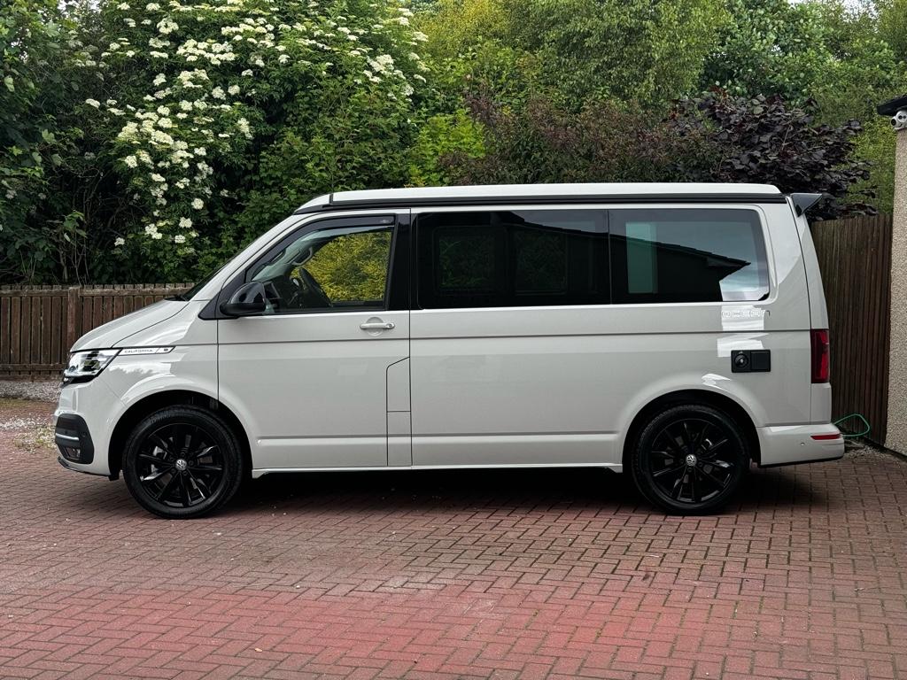

2024 California Lowering Springs
Top = Before
Bottom - After
Measurments
Front 460 Before / 410 After
Back 430 Before / 390 After
Steve's kit is a custom built one for you. Hell guide you on the shocks/springs based on what you want.
So I have the Koni 30mm shorter Shock, with a 50mm lowering spring at the front and 40mm at the back.
As you can see, look is much better IMO.
As much as it wasn't bad before, Motorway driving felt better, dont know what to say other than that, dont do a huge amount of motorway driving so not where I wanted the gains, but happy
Driving on more twisty back roads, I feel more comfortable to continue into a corner at normal reduced speed than before. Previously on the std setup I felt like I had to slow right down as the roll was horrible and the wife was always reaching for the handles thinking it was gonna flip (she has some anxiety from a previous accident) , not anymore!
Speed bumps are softer and not so harsh, as was the gravel car parks ive been in so far.
Overall very happy with what ive had done.
Price wise, £1295 for the kit, £175 for fitting and it took less than 2 hours from drop off to collection.
